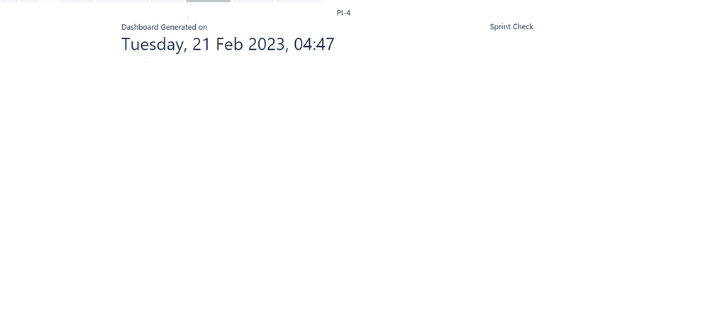

Hi,
Please help me in displaying the ongoing Sprint (say Sprint 1 or Sprint 2 ...) in eazy BI dashboard. It should look similar to the snapshot below.
Under Sprint check. the ongoing Sprint Sprint (1 or Sprint 2 )should be displayed.

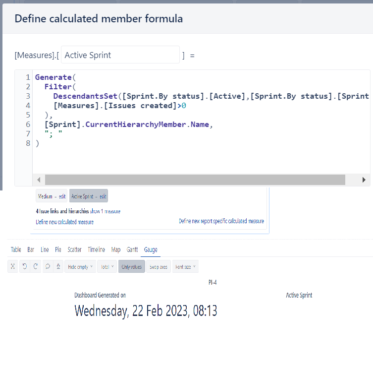

​Create a new calculated measure with the following formula. If there are multiple active sprints, all the active sprints will be listed. More details on Generatel() function can be found here - https://docs.eazybi.com/eazybi/analyze-and-visualize/calculated-measures-and-members/mdx-function-reference/generate
Generate(
Filter(
DescendantsSet([Sprint.By status].[Active],[Sprint.By status].[Sprint]),
[Measures].[Issues created]>0
[Sprint].CurrentHierarchyMember.Name,
​Attached is a screenshot of how this solution might look. eazyBI-Active Sprints-Gauge.png

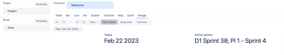

Thejaswi S N
February 22, 2023
Hi @elita_kalane
Thanks for your answer.
I created a new measure with the above code and see nothing coming up under Active sprints
Can you please re-check from your end once

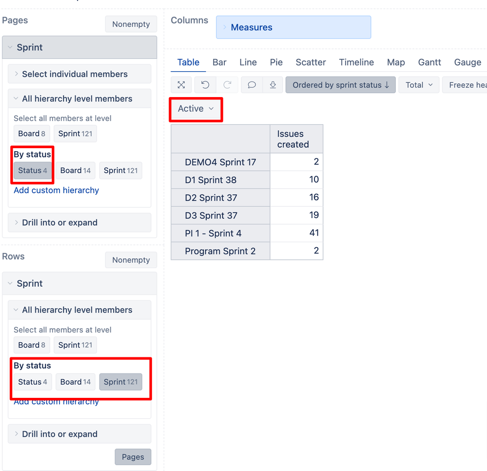

Thank you for following up with me! From the screenshot you sent, I don't see what you have selected in your Rows and Pages, therefor I recommend first verifying what your active sprints are, to know which sprints the calculation should return.
To do that, add your Sprint dimension in Rows and Pages. In Pages, select Hierarchy level member - "By status" -"Satus" and in the filter, select "Active".
In Rows, select the same Hierarchy level member - "By status", but choose member "Sprint", to display the active sprint names.
See the screenshot below with the selections highlighted.

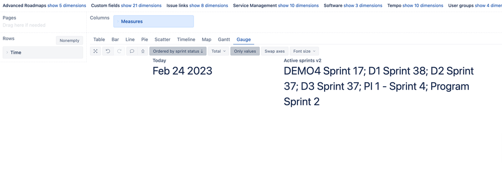

I have also amended the formula I sent you previously, removing the filter which was in the calculation. It could be that the filter function was the reason no data was returned for you.
Generate(
Here in the screenshot below, I have selected "Time" in rows using the formula I wrote above and you can see it returns the same list of Sprints as in the first screenshot when I verified which are my active Sprints.
If still no results are returned for you, please advise (or send a screenshot) what you have selected in Pages and what is currently added/selected in your report Rows.

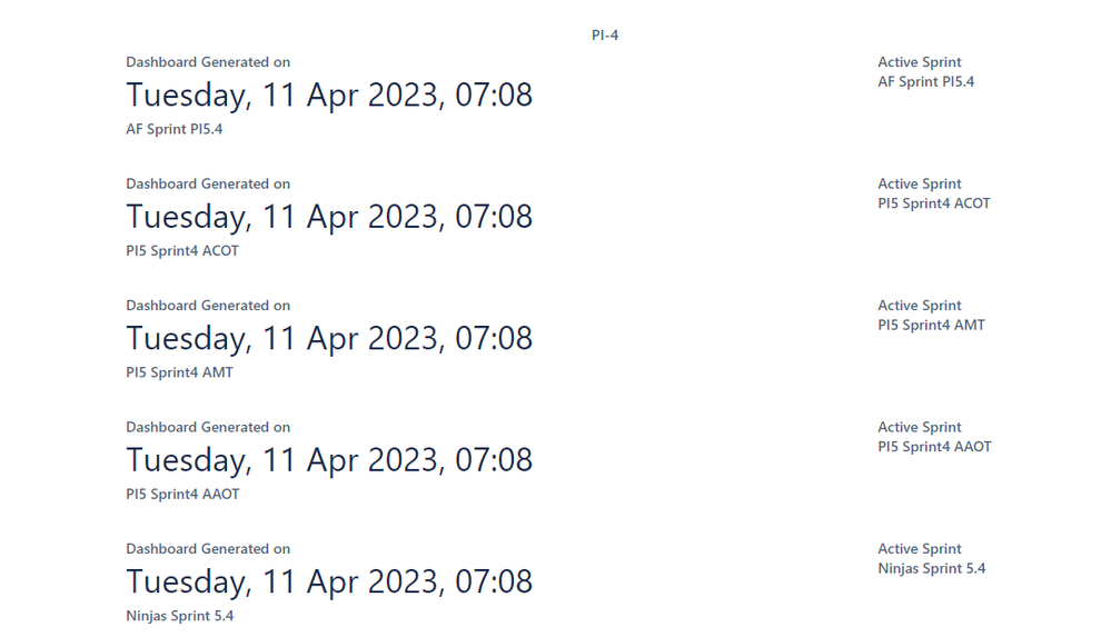

April 11, 2023
Hi @Oskars Laganovskis
We have different naming patterns for a Sprint and I just want to display the active Sprint. In this case, it should be Sprint 4.
Regards,
Thejaswi
