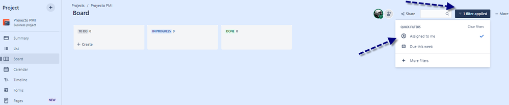

I have the same issue! a business project and missing tasks! no way to edit the built-in board!

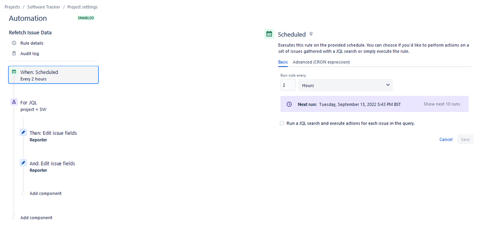

@Svetlana I have just experienced this and can relay my workaround here.
I am using a Jira Service Management - Team Based Project on Jira Cloud.
I have noticed the following behavior:
- Older tasks go missing in Board view.
- Same tasks are not missing in the List and Issue view. I can find them by searching for them manually by key or title but only in these views.
This lead me to believe that Board view has some issues with indexing results for too long, if nothing has changed on them in a while. I have proceeded to find some of these missing issues and edit something simple in one of the fields, such as the Reporter or the Start Date. Immediately after updating any of the fields of the issue, it has reappeared in the Board view. This is independent of the status the issue is in. It will disappear after a while regardless if it's in `Work in Progress` or `Done` states.
As a workaround for this issue, I've created the following automation.
Every 2 hours, it removes the Reporter and then sets it again to `Automation for Jira` for every issue in the project. This may cause some slow performance but at least all my tasks are there in Board view when I want to see them.

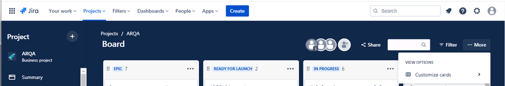

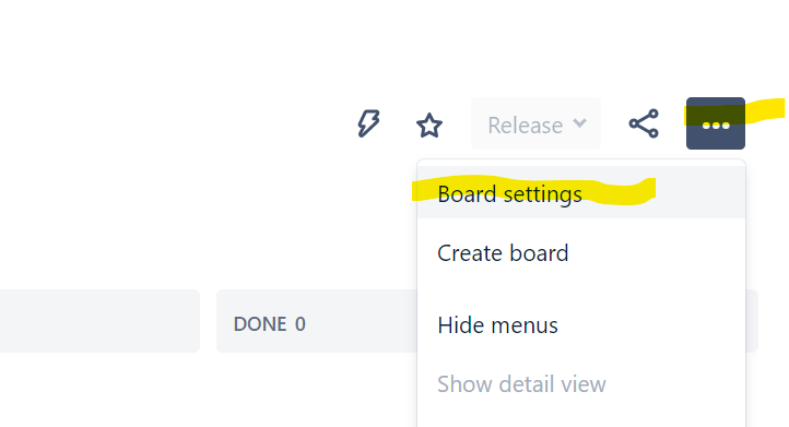

No, it would be board settings. While you are on the board, click on the 3 dots menu in the upper right.

Svetlana
June 29, 2022
i have following settings
John Funk
June 29, 2022
Sorry, I forgot it is a business project and you can't change the board with those.
So, I assume this is normal operation for the board that the issues/cards disappear after two weeks from when they are moved to Done. You cannot currently change that with the board for Business projects.

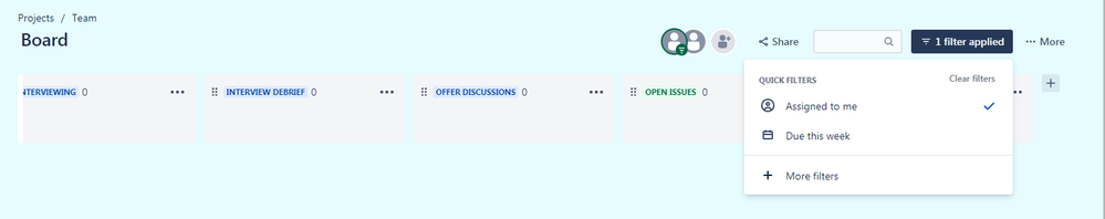

Hello @Svetlana ,
Please allow me to step in as well, checking out the conversation up to this point I think @Marcos Milanesio  is on the right track looking at the Filters that are applied,  as the filter that you have applied currently will only display issues that are assigned to you.
That means any unassigned issue or issues that another user assigns to themselves will not appear on the board and would look like they disappeared based on another user's actions.

Svetlana
July 6, 2022
Thanks! In my situation tasks of other members were disappeared with status"done', "open issues" and "ready for launch'
Thanks for explanation about the status 'done'. There are questions of other statuses. Why tasks of other members with statuses " open issues" and "ready for launch" are disappearing from board, but exist in extended list of tasks?

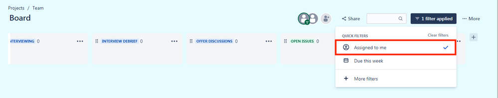

Hi @Svetlana ,
Per you last question:
Looking at the screenshot you posted you have the "Assigned to me" quick filter applied:
When this filter is applied only issues where you are the assignee will appear on the Board.
