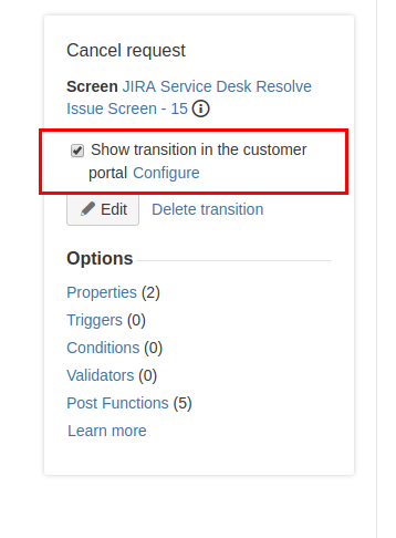

If you mean deleting by cancelling, you need to check your project's permission scheme. If you remove customers from your delete issue permission, it should solve the problem.
If it's a transition, you can find the transitions that you share with the customer on the workflow of your project. The ones you share looks like this:
If you remove this, they won't be able to cancel the issue.
