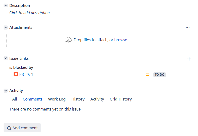

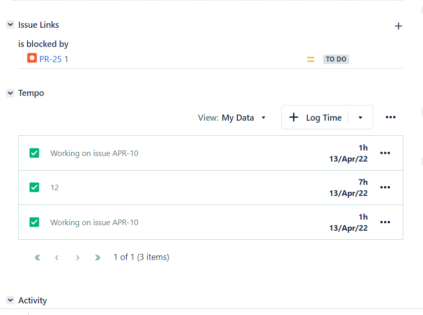

Before LF:
After LF:
Hope this will work for you or at least give you an idea of what you can try in your particular use case.

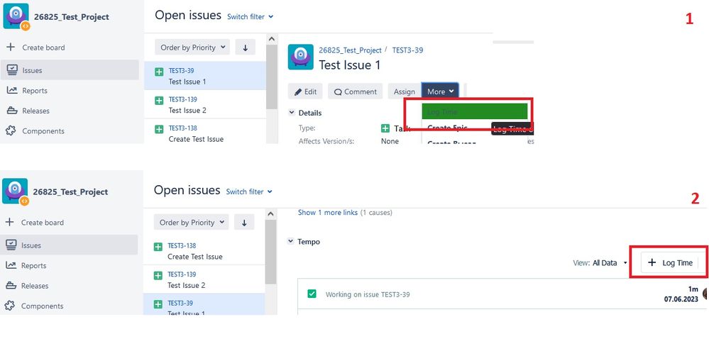

Hello @Anna Hryhoruk _Appfire_
Haven't found a solution yet. I liked your solution. I managed to hide the fields in the task. But when viewing a task in the list of all tasks, it is not possible to hide the fields.
Can you help me with this?
