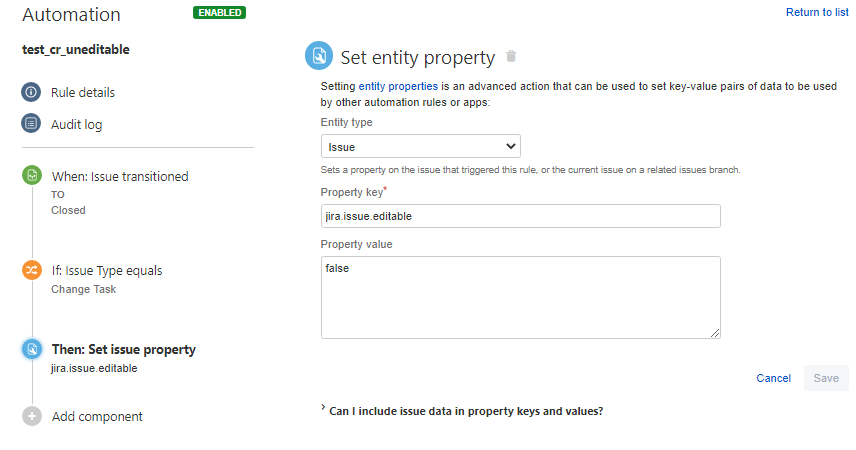

The use case is that when a Change Request(an issuetype) is in "Closed" status ONLY users of a particular user group should  be able to edit or modify links,attachments,issue fields of all Story/Features in that current sprint.
Just changing the workflow property wouldn`t work as when  the Change Request for that Sprint is not in closed all users should be able to edit and modify issues.
Also we have Power Scripts, so using SIL can also be an option if there is a way of achieving this using SIL.
I have tried the below automation rule with "Set entity property" action but it is not disabling the edit permission.

Hi @Soham Das ,
interesting question!
Unfortunately, the properties you are mentioning are workflow properties, not issue properties, so I do not think you can configure this in that particular way.
Whenever I need to make editing conditional, I usually remove permissions for editing altogether by using the workflow properties you mentionned on the statusses, and use conditional "Any status" -> "Itself" transitions to allow the edits whenever I want (and for whatever fields I want).
If you have apps like Scriptrunner or JSU, you can make the transition conditional to a JQL (e.g. a JQL to check for closed change requests), so users only see the edit transition when they are allowed to.
