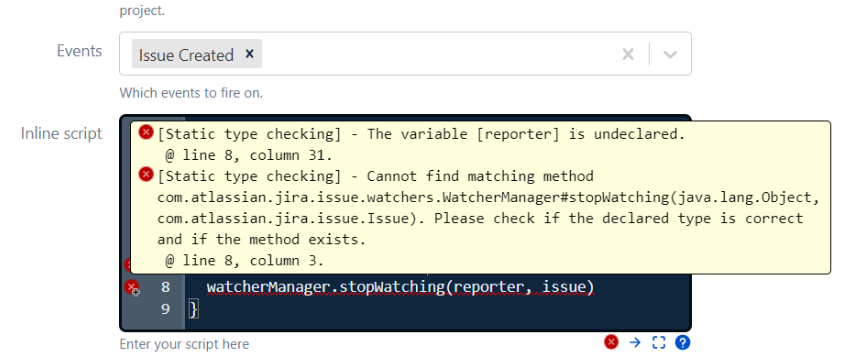

Hi Turov,
Thanks for the reply!
I have added the script in the script listeners for issue created event. However, still autowatch is disabled for all projects.
It is showing below error in line 7 & 8:
Below error in the logs:
2019-08-26 14:08:03,302 ERROR [runner.AbstractScriptListener]: *************************************************************************************
2019-08-26 14:08:03,302 ERROR [runner.AbstractScriptListener]: Script function failed on event: com.atlassian.jira.event.issue.IssueEvent, file: <inline script>
groovy.lang.MissingPropertyException: No such property: reporter for class: Script338
 at Script338.run(Script338.groovy:7
