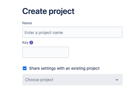

Is the original project a Team Managed project or a Company Managed project? It will say which it is in the bottom of the navigation pane on the left.
If it is a Team managed project, there is no way to create a new project that immediately has all the same settings as the original project. The intent of Team managed projects is that they all operate autonomously by teams that want to have their own customizations. They are not designed to share such customizations.
If the original project is a Company managed project, then yes, you can create a new project that shares the configuration (workflows, screens, fields, notifications, permissions) as the original project, but you have to manually set up the configuration for a board for the new project.
If the original project is a Company Managed project, then a Jira Administrator can create a new Company Managed project and select the "Share settings with an existing project" option, and then specify the original project. The new project will then be created to share the settings I mentioned above. Note that if the Jira Administrators then change the settings, both projects will be affected.

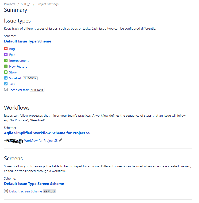

1. Show us the Summary page under Project Settings for the original project, so we can see the names of the Schemes associated with that project,
2. Repeat the process of creating a new project, walking us through the steps, screen by screen, that you went through to create the new project, telling us all the selections you made along the way,
3. Show us the Summary page under Project Settings for the new project, so we can confirm that the Scheme names in the new project are the same as the original project. If the scheme names are not identical, then the projects are not sharing settings.

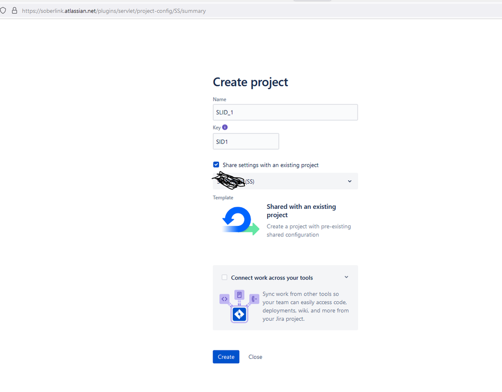

I just walked through the steps again and got some screenshots.  Here is what I am doing.
Here is the original project settings summary:
1. Project - New Projects - Select Scrum
2. Use Template
3. Select a Company-managed project.
4. Enter Project Name, Key. Choose "share settings with an existing project." Choose existing project displayed in summary page screenshot. Leave "Connect work across your tools" unchecked. Click Create.
5. View project, workflows, summaries, all look well.

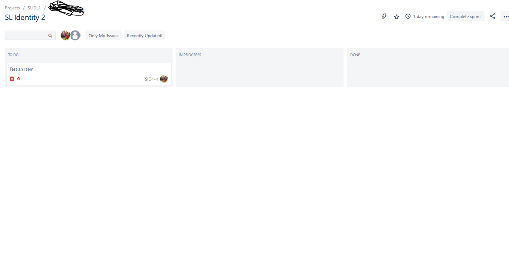

6. Click on Board, Project does not have any board.
7. Create a Scrum board, board from an existing project, click next.
8. Enter board name, select new project I created in Project dropdown. Ensure Location is set to project I just created in Location dropdown, click "Create Board."
9. Click on Active Sprints.
Do you see anything I may be missing or doing incorrectly?
At this point the statuses are once again defaulted to only the 3 "TO DO", "IN PROGRESS", "DONE". Not the multiple statuses shown in my previous project, or workflows. This is basically where I am stuck.

You're talking about the columns you see on the board.

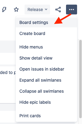

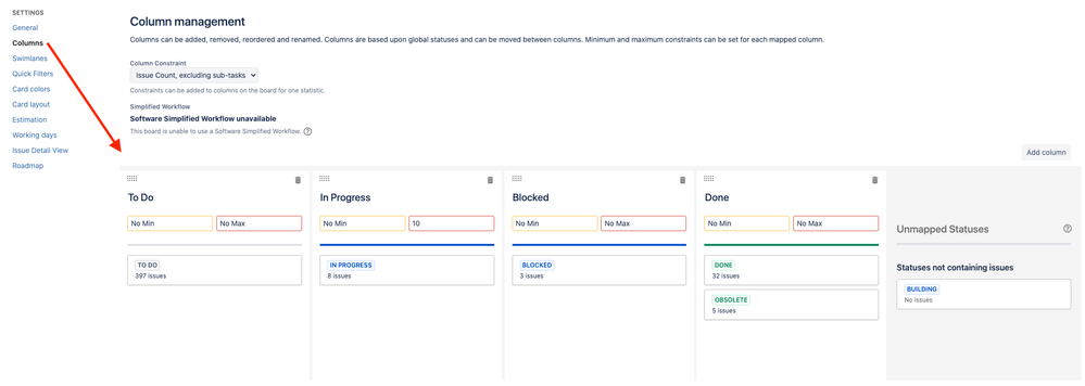

By default, when you create a new board you get the columns To Do, In Progress, and Done. These are not the Statuses of your workflow. These are just names for the columns, and you map your workflow Statuses to columns.
You need to go into the Board Settings > Columns page to configure the columns. There you can make new columns and rename columns, and map the Statuses available in your workflow to your columns.

@Trudy Claspill that was exactly it.  Thank you so very much (and @Jack Brickey as well) for getting me sorted!
