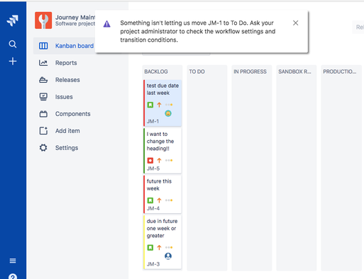

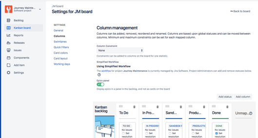

I have a project, which has simplified workflow active;
Screen Shot 2018-04-23 at 5.01.07 pm.pngHowever when I try to change the status by dropping and dragging between columns, i get the following error;

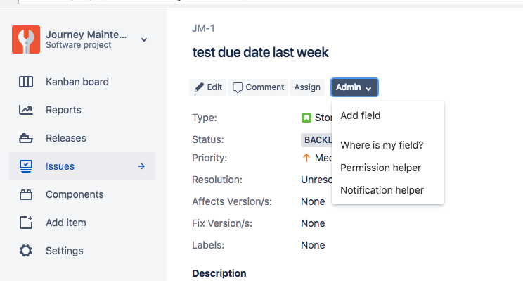

On the issue, there is also no where to amend the status;

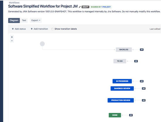

Your workflow shows as a draft. Please either publish or check the active workflow.

When you drag to story from the 'Backlog' column, are you trying to drop the story on a column that is not highlighted within a dashed box? If so, this means you do not have a transition setup between these two statuses.

here is the workflow? should i be looking elsewhere? the columns are not highlighted when dragging.

Do you have any conditions/validators for the transition (e.g. required fields)?
