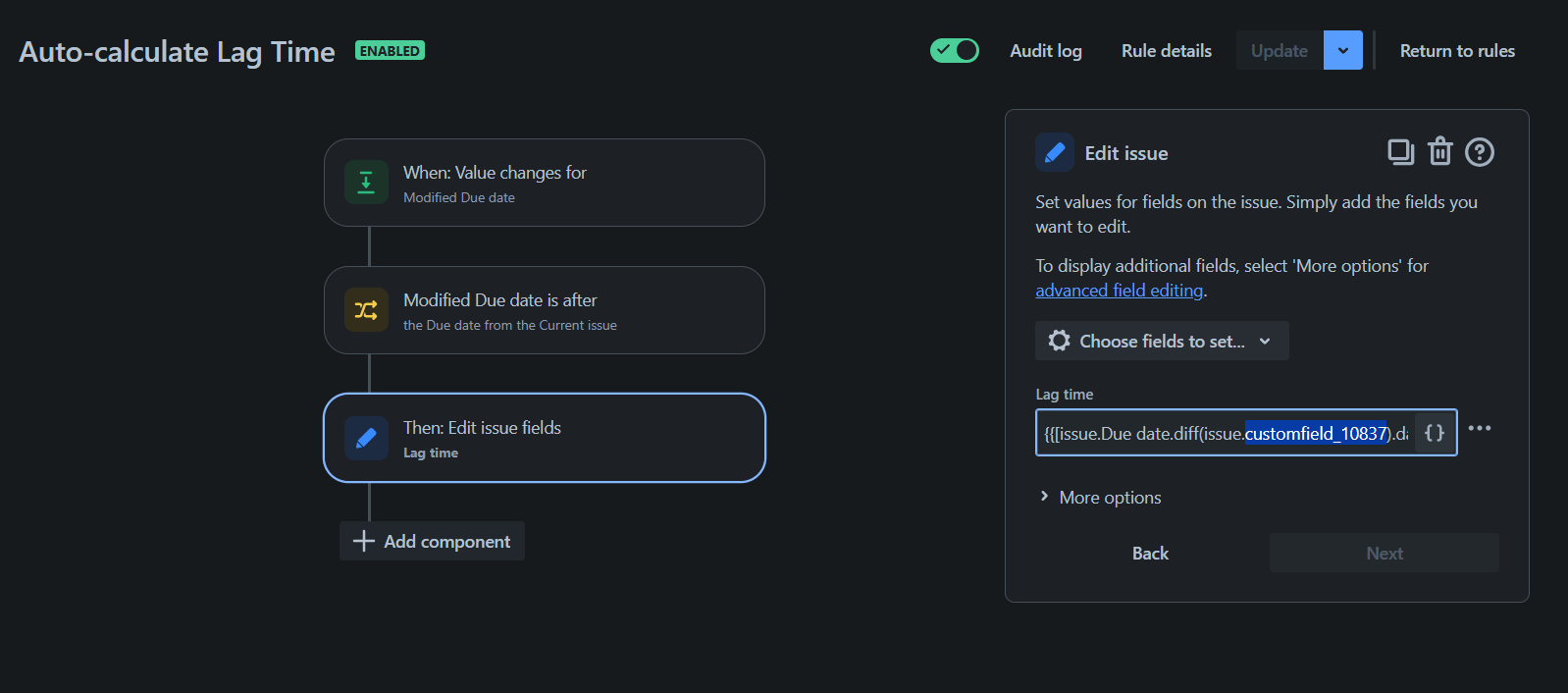

I have 2 fields Due date and Modified Due date. I want to get the difference between these two dates in days.
I tried the following formula:
{{[issue.Due date.diff(issue.Modified Due date).days}}
Then I tried even the Field ID:
{{[issue.Due date.diff(issue.customfield_10837).days}}
But that still does not work, The rule runs successfully but the field Lag time is never updated with value.

@Tehmina Aslam
Can you copy the calculation in smart variable and then use that smart variable to update the issue? i think it should help resolve the issue.
Also there looks to be an extra [ bracket before Issue. That is not needed
Share your audit log as well
Tehmina Aslam
February 12, 2025
Thanks man, there was an extra bracket :D
{{issue.Due date.diff(issue.modifiedDueDate).days}}
