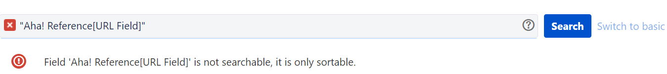

Appreciate your solutions and quick response. I can definitely do the first solution that you suggested to associate the 2 screens to the other field. I tried to search by the custom field ID, it works for one of the id but throws an error for the second one.
Would it be safe to assume that this field hasn't been populated yet or has no data ?

It likely is not used. What I might suggest as a first step is to simply rename the field. This will allow you to search for it independent of the other duplicate name. Also if anyone is using the field they will get confused by the renaming and contact you or another ad man I would assume.
