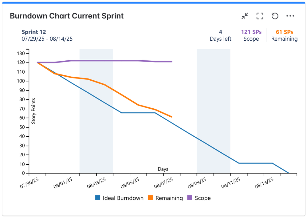

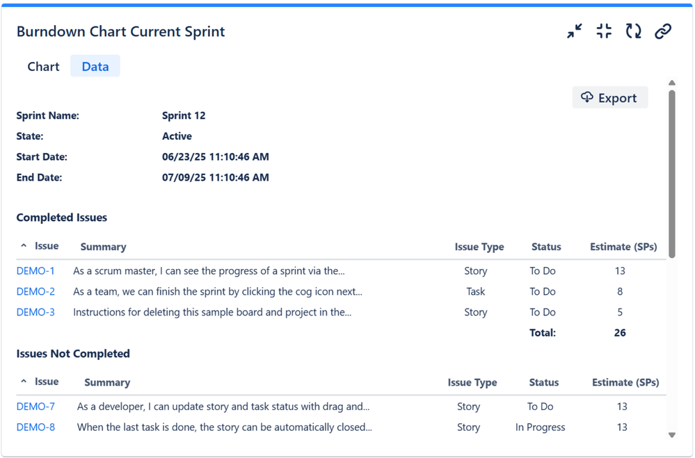

In case you want to try an app for this, our Great Gadgets app offers a Sprint Burndown Burnup Chart gadget that could be helpful for your need.
On its Data tab, this gadget displays a report similar with the Jira Sprint Report.
This report can be exported in CSV format.

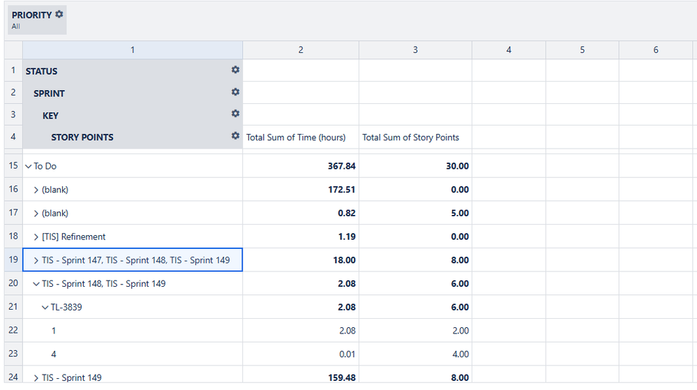

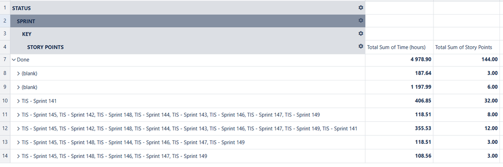

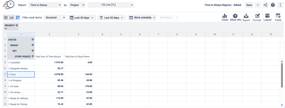

I was intrigued by your use case and recreated it in our Time in Status app, which supports a flexible Pivot configuration. Could this setup work for you?
How I configured it
  1. Select scope
    • Project: chosen project
    • Filter: issues updated in the last 30 days
  2. Set Pivot rows (in this order): Status → Sprint → Key → Story Points
    • Status shows the issue’s current status.
    • Expanding a Status reveals all Sprints in which the issues occurred during the selected 30-day window.
    • Key is the issue identifier.
    • Story Points can display multiple values if they have changed over the life of the issue.
Note: A blank value in Sprint or Story Points means the issue wasn’t in any sprint or had no story points assigned, respectively.
This view lets you track the history of changes over a chosen period and how issues moved between sprints.
Another featureSprint Report, also shows Carryover—the percentage of work that rolled over from the previous sprint into the next.
I hope this is helpful!

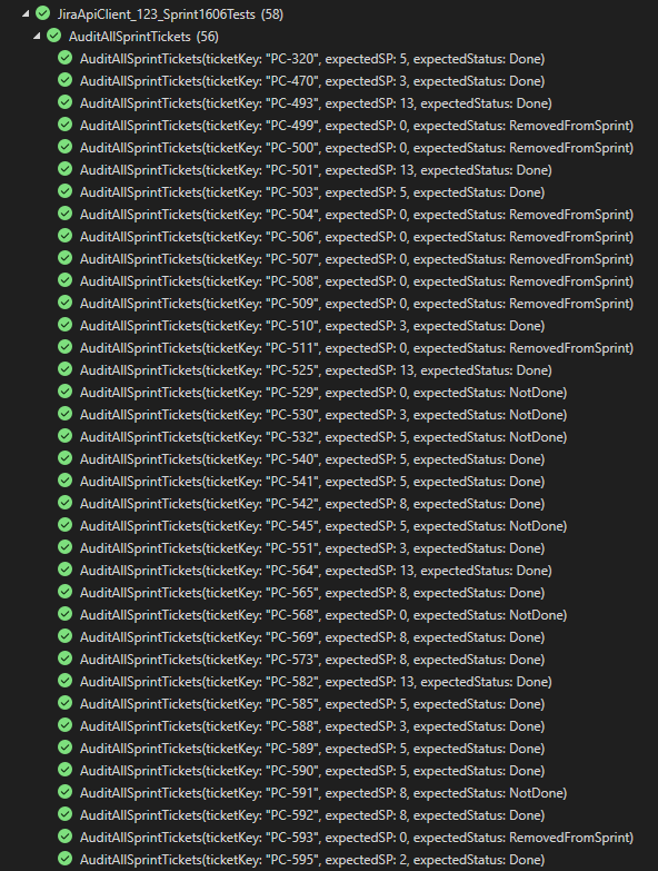

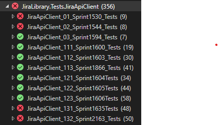

Just forgot to mention : did you check if you data was really matching jira UI in every sprint. Because some of my "not done" issues are spotted correctly.
I built some unit test for every sprint, and every issue in each of one them, trying to spot the wrong ones. And most of my sprints are correctly spotted :
and it's every kind of status which can be ok :
So I won't say you're wrong, but I could provide a UI as yours, and without my unit tests, i wouldn't know some issues were not identified correctly.

I juste wanted to display some jiras informations into a custom intranet for my company. I tried not use the changelog, I tried A LOT.
I could tell you 100% sure that "which was in the sprint when it started and when it completed, and determine what you asked." is not possible. Every time I tried something new, I found an example breaking the rule.
For example, I found two stories, each one was in the sprint when it started, was removed from the sprint at the sprint endate (complete date). Both at the same time (only 100 millisecondes appart, both after sprint end).
One was removed from sprint. The other one was "not done".
If there is a rule I can apply using changelog issues, I'll try. But I would like the rule, using changelogs items, and sprint informations. I don't know why to try next.
My new "lead" is to use JQL. It seems like when I use this :
sprint = 2163
AND status WAS not Done ON "2025-09-04"
I only get "not done", and no "removed from the sprint" is sent. So i could use my algorythm, get every issue which wasn't done at the end of the sprint, and try some
"my issues not done in C# minus the one I've got from JQL" and get the "removed from sprint ones. But I have to try, And it's kind of a shitty way to do it.
I would to have the rule to determine if an issue was not done or removed from sprint when getting the sprint issues using changelogs ....

That's why I spent the last two weeks. It's seems there is no way to determine it correctly. I was hoping an atlassian employee would have the answer.
I really tried everything I could, even some stupid thinking looking at milliseconds, other fields values not related, etc...
