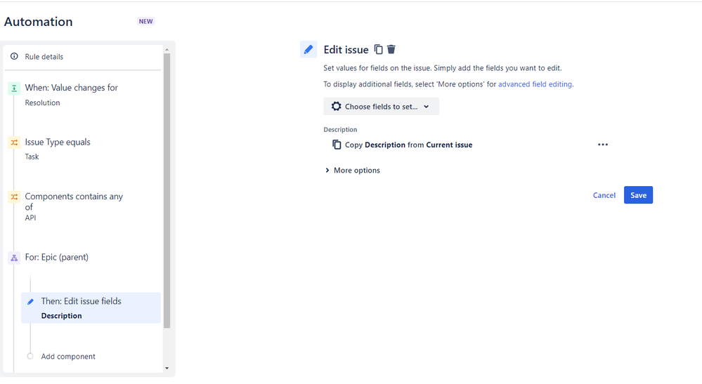

Off the top of my head, I would approach it something like this...
1. I'm triggering off resolution being set (do this however you prefer)
2. I'm making sure it's a Task (as you indicated)
3. I'm checking for whatever is identifying that one specific task you need. In this case, I am going to assume we are using a Component of "API" as an example.
4. Then I branch up to the parent Epic and copy the description.
I hope this helps!
