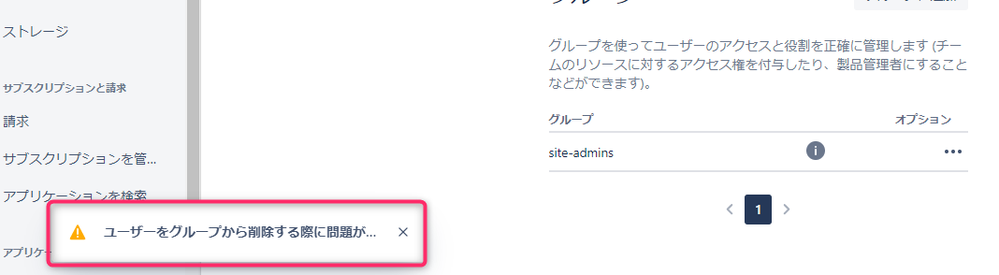

Pavlo Shynal
February 25, 2021
@Prince Nyeche When we are trying to revoke access for the user, who has org&site admins access, it shows us a notification (see left bottom corner)
Prince Nyeche
February 25, 2021
Hi @Pavlo Shynal
Please can you remove the image above as it contains email address of your users. The reason why you get that error is because for you to remove an Org admin, you will need to first remove the Org admin ability from your settings as show on the below image.
After that, go to your user hub https://<your-instance>.atlassian.net/admin find the user and remove them from the site-admin group.

@Prince Nyeche
I have a free plan but I have problems trying to remove myself from Jira.
Do you know how to erase 'site-admins'?
Prince Nyeche
March 4, 2022
You cannot remove yourself from the site-admin group. You have to use another user who has site-admin privilege to remove it.
