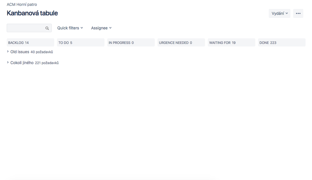

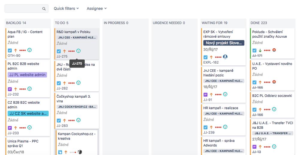

Tereza Hrdličková
October 2, 2018
But when I created swimlane, then the board will split into 2 boards - new and old issues...Snímek obrazovky 2018-10-02 v 13.05.44.png
And after swimline
Snímek obrazovky 2018-10-02 v 13.10.18.pngSo the board is still soooooo long :/
