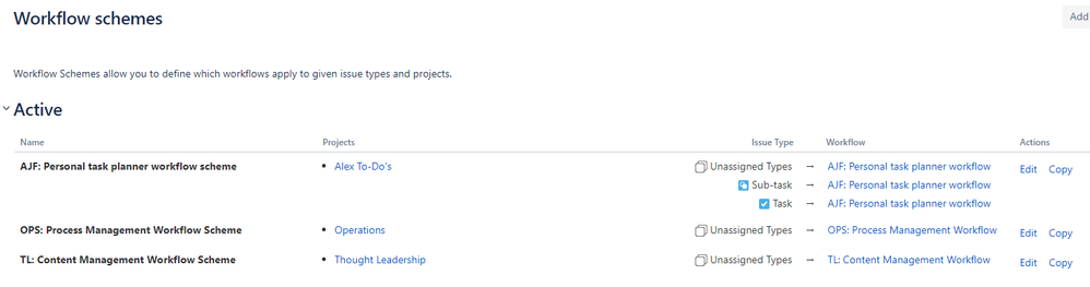

So we are very basic Jira users.  I'm sure Workflows have a good purpose, but frankly they are making my team and I nuts!
We managed to make 3 boards with workflows and want to remove them all.  I see them listed as active, and I see how to edit or copy them, but how can I inactivate them so that the boards do not have a workflow at all?  End goal: Be able to create tasks in any column on each of these boards.
Thanks in advance.

The active/inactive flag is calculated, it's not something you set on a workflow.
Basically, active workflows are those configured to be used by one or more projects (via the "workflow scheme"), and inactive ones are not, so they can be deleted.
You can't have an issue (and therefore board or project) without a workflow.
You say "End goal: Be able to create tasks in any column on each of these boards. "
You can't do that.  Issue create has a single landing point, usually (but not necessarily) the first column.  Moving issues between columns is actually pushing the issues through workflow transitions so that the status changes.
If your goal is more "be able to move an issue from any column to any other column on the board", then you will need to define a workflow that is made up of a very simple set of status and transitions.  A very simple example would be three status (mapped into three columns, probably with the same name):

Hi Alex,
You make workflows in active by removing them from the Project they are attached to. Workflows aren't really attached to boards, they are attached to projects. Boards are connected to projects based on the filter that is used for the board.
Therefore the workflow is associated with the board because of the connection through the project.
