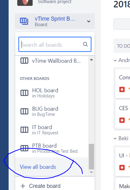

It's also moved again for me - now I go to my current sprint board, then click the drop-down
Then at the bottom of the drop down I 'view all boards'
Then that gives me the option to manage, delete ect.

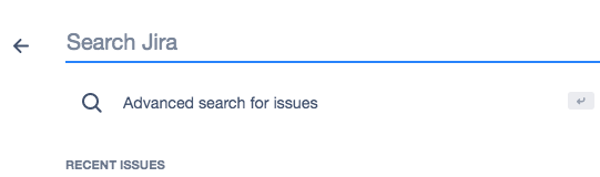

this is honestly terrible from a user perspective. I could not get it to show up at all using the above methods.  Then  i typed the letter A in the search bar with the magnifier and now all of a sudden view all boards is visible. I wouldn't have found it all all if not for these posts though. thanks

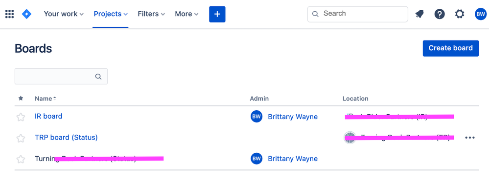

Brittany Wayne
August 22, 2021
I'm able to get to the list of boards but there are no ellipses next to the inactive board I want to delete (the third one). I also cannot click on the name of the board to open it - it's completely inactive. I'm the org & site admin and in the jira-administrators group. Any ideas for how to delete??
Sina Abdi
August 23, 2021
@Brittany Wayne I just ran into this and its because (at least for me) the projects with no options were actually in the trash. once I permanently deleted them, they boards disappeared as well.
To Perm Delete Go to:
1. Settings (Top right Gear Icon)
2. Projects
3. Trash
4. Option to permanently Delete
Like # people like this

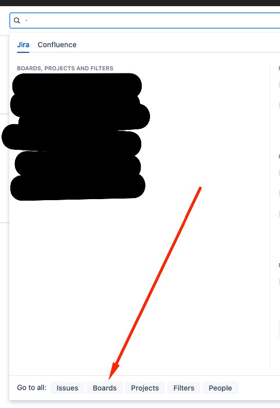

June 21, 2022
It hidden in the search bar:

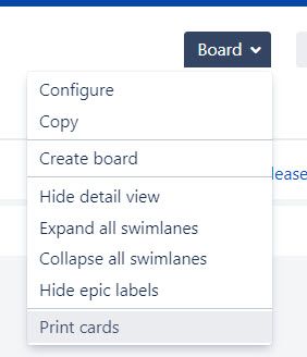

In the version of JIRA that I use, you have to be in the configuration page for that board.  Once you  are in there then you can click on the board menu and you will see the delete option.   I had to go through all the options mentioned above to figure this out.  :(
Kal Kalotai
September 10, 2020
can you post a screenshot?  running into the same problem and cant find the delete/remove option anywhere... :(
Laura Colon
September 10, 2020
Sure, you first need to select the board. Then click on the board button and select Configure.
After you click on configure you will see the Board button again.  Click on it again and you should see the Delete option.

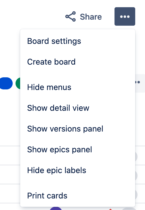

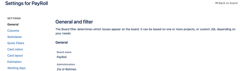

For me there is no such dropdown:
I see this
And on clicking on board setting i get this:
