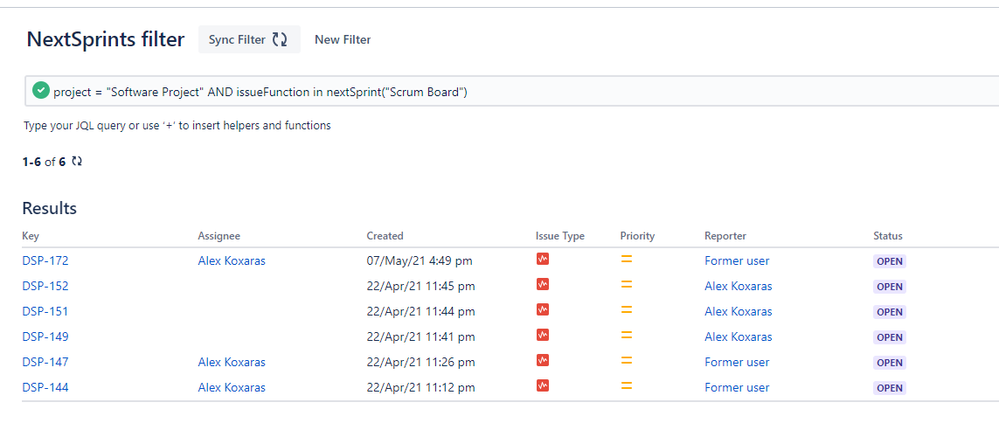

I've tried the following JQL on the scriptrunner enhanced search:
project = "Software Project" AND issueFunction in nextSprint("Scrum Board")
and it worked fine! However, the "Scrum Board" is indeed a scrum board. Can you please check that the board you are using is a scrum and not a kanban board?

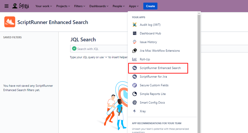

Nextsprint can is a JQL from scriptrunner. TO see if you have enhanced search:
  • go to header menu -> Apps
  • ScriptRunner Enhanced Search

Scriptrunner dynamic filter:

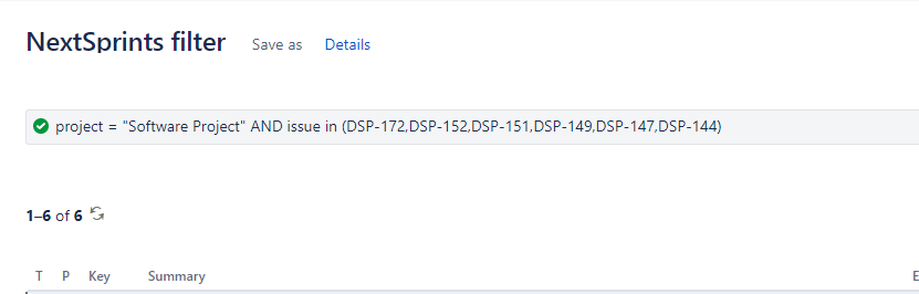

Jira "synced" filter:
As you see in the image above, the synced filter return the actual issue ids
