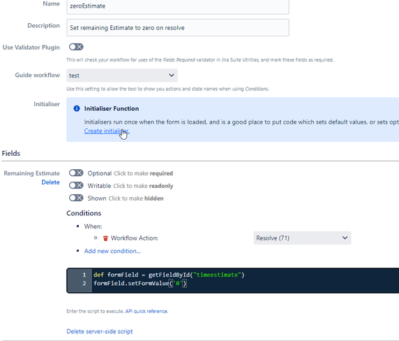

Yes, you can do that with scriptrunner by adding a behaviour as shown in the screenshot.
Specify your workflow, conditions and serverside script in the behaviour.
Also make sure the timetracking fields are in the transition screen.

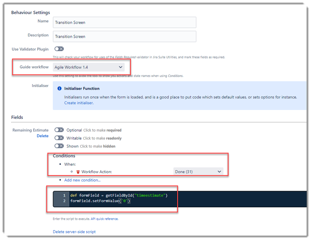

Arin Lipman
July 17, 2020

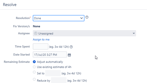

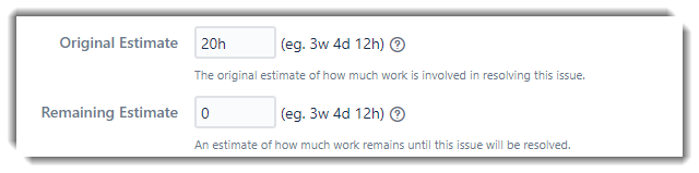

Hmm, on my issue screens (Jira 8.5.3), the Time Tracking field-group does not include the "Time Spent" field, so there is no radio button that disturbes setting the value.
Here is how it looks:
I was not able to find out where to configure the "Time Tracking" field-group, so that it does not include the "Time Spent" field. Im quite sure however that you can configure that somewhere, and then the behaviour should work.

Interesting.  I have the Log Work field in that screen.  If I add (not even removing the Log Work field) , I get the fields you have.
