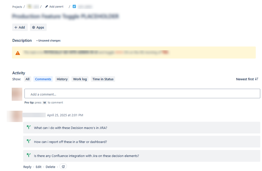

I have used the decision macro in confluence a bit, and relatively recently noticed they are present in JIRA. Do they serve any purpose/have any actual utility in Jira other than a visual demarcation of a decision being made? ie; can i write a filter to say "project = X and Decision IS NOT EMPTY?" to display all our decisions? or can this integrate with Confluence? etc?

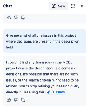

I am not aware of any extra search / reporting features on the decision macro in Jira. Maybe at some point this will become possible, but even Rovo let me down when trying to find them at this point 😅:
So: mainly cosmetics for now indeed!
