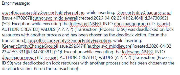

We are currently facing frequent deadlock issues during status transitions in our system. After analysis, we have identified that the issue appears to be caused by the PII plugin.
We have attached the relevant error logs for your reference. Based on our observations, this deadlock occurs consistently when transitioning statuses, and as a result, all automation webhooks are failing.

There are no log attached to this post.
But as this seems to relate to a 3rd party app from a vendor on the Atlassian Marketplace, raise your issue on this at their support portal.
The communtity is here to help other users, but issues relating to specific apps or instance, should be raise at the app vendor or Atlassian Support
Check this KB; https://support.atlassian.com/jira/kb/deadlock-errors-in-logs-when-running-jira-with-sql-server-database/
Or contact Atlassian Support
The label "addon-com.enhancera.pii.pii4jira" identifies the PII Protector app, developed by Enhancera.
Their support desk is here: https://enhancera.com/contact.html
Only they can help with it, as the root cause is related to their app.
