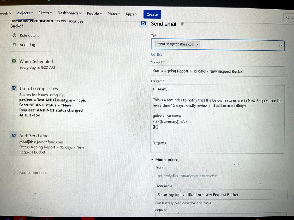

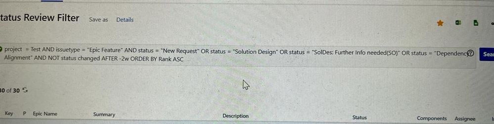

2. I wanted to notify certain stakeholders if an issue sits in certain status more than 15 days(I have attached the JQL query which I had used based on your responses on similar topics in other threads. The JQL results is coming with a wrong output and I am seeing issues which are created same day, yesterday and less than 15 days also)
Can you please review and suggest me a better JQL query which can fulfill this.

Starting with the JQL you are showing, please note queries evaluate AND before OR, causing some problems when you do not order your clauses or use parentheses to get what you want.  I encourage you to take this free training from Atlassian on tips/techniques to writing JQL queries to learn more: https://university.atlassian.com/student/path/849533-gain-project-insights-through-jql
For your query, this behavior can be addressed using status IN (A, B, C) such as with:
project = TEST
AND issueType = "Epic Feature"
AND status IN ("New Request", "Solution Design", ...)
AND NOT status CHANGED AFTER -2w
ORDER BY Rank ASC

Finally for your question on reporting on issues which have not moved in 15 day, it appears in your rule you have already implemented that.  What is not working as you expect?

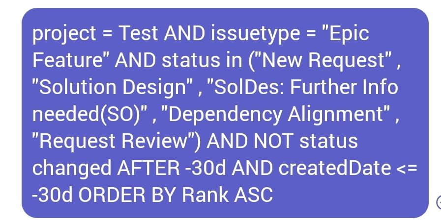

After applying the above mentioned JQL, I just noticed if I create a new issue type which by defaults appears in my 1st Status is also reflecting on the above query. I tried moving this new issue to other status and checked the ageing report which also showing this new one under the list.
Tried an alternative by adding AND create <= 15d along with above query gives me an outcome with that new issue. Same logic when I tried with 30 days and 90 days ageing as AND create <= 30d and AND create <= 90d respectively.
Do you think this is a right query or should I reconstruct some other thoughts. Can you suggest me the best option to obtain this.

I am not quite following what you describe.  Are you noting that an issue which was just created is being returned by the query?  If so, adding a condition to check the created date should help.  If not, please post your complete current JQL; that may indicate what is happening.

Attaching the screenshot of the query that I have modified with created date <=30 days.
Yes, without that, an issue which was just created is being returned by the query.

Is the above query mentioned by adding the created date is valid? I saw the newly created issues disappeared but still not so confident with results 😂
Need your expertise advice

The answer depends upon what you wanted to accomplish.
With your addition, that query will ignore any issues created after 30 days ago.

The outcome I am expecting is to pull a report with the list of issues sitting in a particular status more than 15 or 30 days

You have written the query to answer your 30 days question.  If you change AFTER -30d to AFTER -15d you will have the other one.
