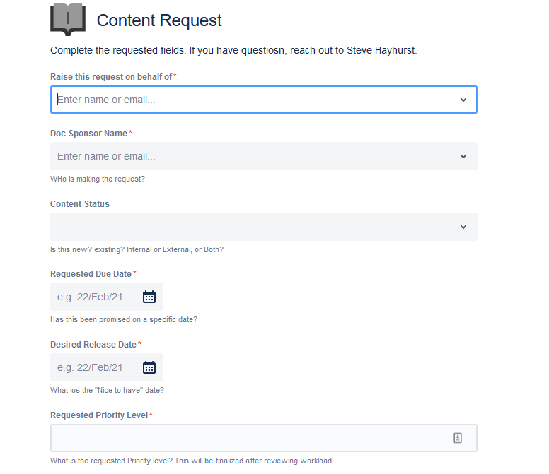

Creating  A Doc Request form using the JIRA Service project and custom fields. For my "Requested date" custom field, for example, when I preview it in the Portal, it asks me for the date format as follows:
 17/May/21
What I want is:
  02/17/2021
I changed to the "MM/dd/YYYY"  date format in the "Look and Feel" (../secure/admin/LookAndFeel!default.jspa) settings, but when I go back to the Preview option, it still looks for the date format of "17/May/21".
What am I not changing correctly?

So I made the change, but in the Portal Preview, the date format is still "17/May/21"

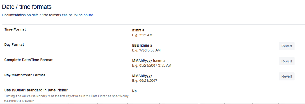

Steve H_
February 22, 2021
Attached; first capture is the Look and Feel section from the Settings and the second is a Portal Preview shot of the Request form.

@Steve H_, this is not configured in the look and feel settings but in the JIRA user interface via options on the Advanced Settings page.
Editing JIRA's advanced settings
To access and edit options on the 'Advanced Settings' page:
1. Choose  > System.
2. Click the Advanced Settings button on the 'General Configuration' page.
3. Edit the value of a Key by clicking its value on the right of the page and modifying the existing value.
To update the parameters you're looking for, have a look at Changing the Due Date Input Format. You need to update the following
  • jira.date.picker.java.format property
  • jira.date.picker.javascript.format property
Cheers.
