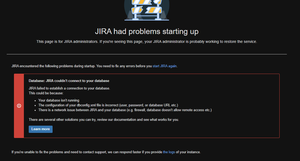

I faced a problem to run Jira.
Server version, 7.9.0, via docker.
I didn't changed anything but it doesn't work suddenly now.
When I start it and try to access it's web pages, it shows me an error page as below.
I checked dbconfig.xml but couldn't found any special things.
Only one thing that I doubt is I'm not sure if that user name is correct or not. Of course I didn't changed, but I found that the e-mail address of this user id is incorrect. Is there any idea that I can check if this user id is alive or not?
And jdbc:postgresql://postgresql:5432/jira, I tried to check if the port 5432 is opened or not, but it seems ok.
LISTEN 0 128 [::]:5432 [::]:* users:(("docker-proxy",pid=29867,fd=4))
Or if there is any other idea or if you need further information, please let me know.
Thank you in advance!! :)
Best Regards,
JESuh

Piyush A (STR)
March 16, 2022
Hi,
per the question: It was working earlier but now isn't working  - correct?
Try to connect the database from the server. I see you've already tried for LISTEN, but port could be an case here.
Also, password reset and make changes to the database once. Meanwhile - install a Postgres admin UI for the database and check the connectivity.
