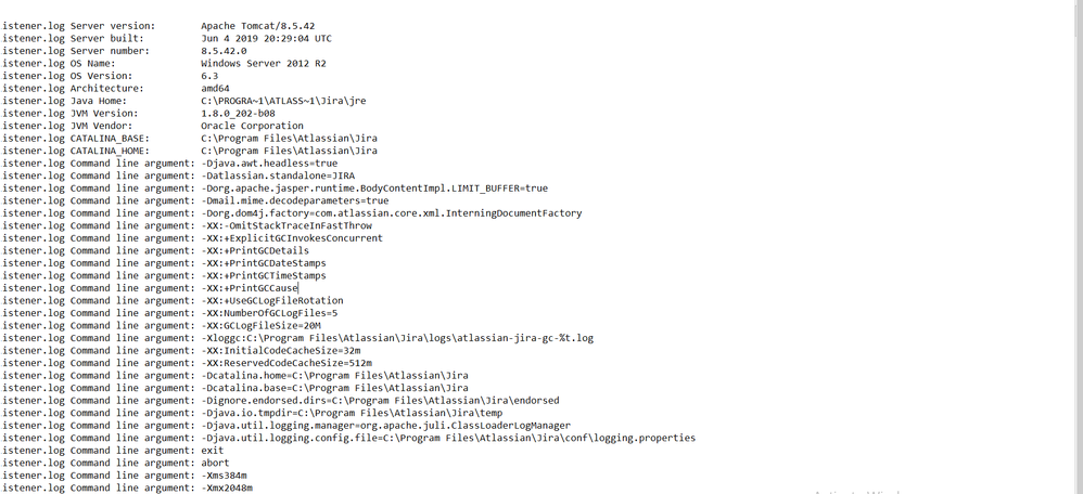

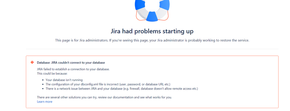

i am currently using JIRA v8.7.1 on windows server 2012. After restart the server I cant access the JIRA dashboard. i have already checked the database file and config but still cant login the jira dashboard.
2021-03-20 14:45:35,293+0500 Caesium-1-1 ERROR ServiceRunner [c.a.t.healthcheck.concurrent.SupportHealthCheckProcess] Health check Embedded database failed: Jira is using the H2 embedded database. You should migrate to a supported database to ensure your data is safe.

I'm afraid I can't tell you any more.  You'll need a clean Jira install, using a supported database and restore your data from the backup.
haball-pk
May 26, 2021
I have tried to restore backup on new Jira server but can't restore the complete data from XML file.
Nic Brough -Adaptavist-
May 26, 2021
I suspect this actually means that your h2 database is damaged and unreadable.
You'll need to get a clean install of Jira, ideally connected to a proper supported database, and restore your data from your last backup.
