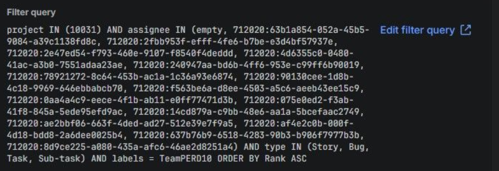

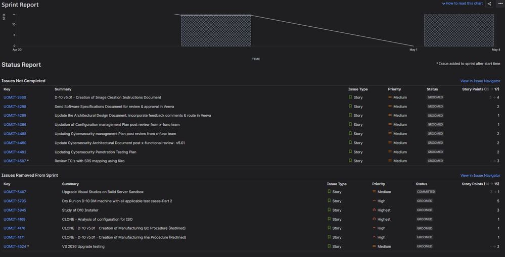

Hello @Ankit Srivastava thank you for your quick response and yes, I am doing well and hope the same for you!
I have looked over the first 3 bullets you listed, and everything looks good, so I am attaching a screen shot of the report showing no closed Jira tickets and the filter of the scrum board.
It won't let me add the filter in JQL format

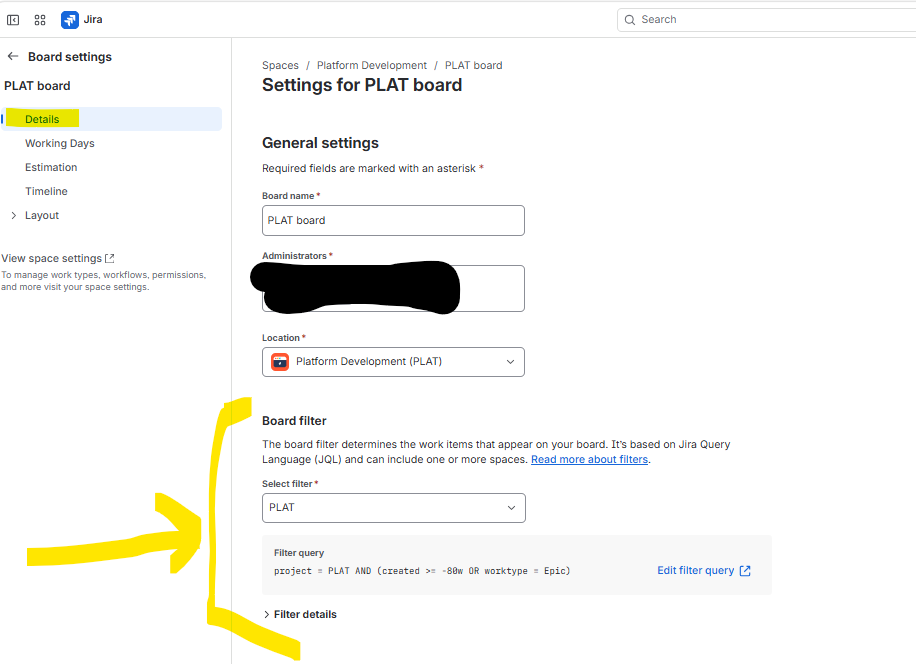

Ok.. could you please share the screenshot of the board filter, as below screenshot:

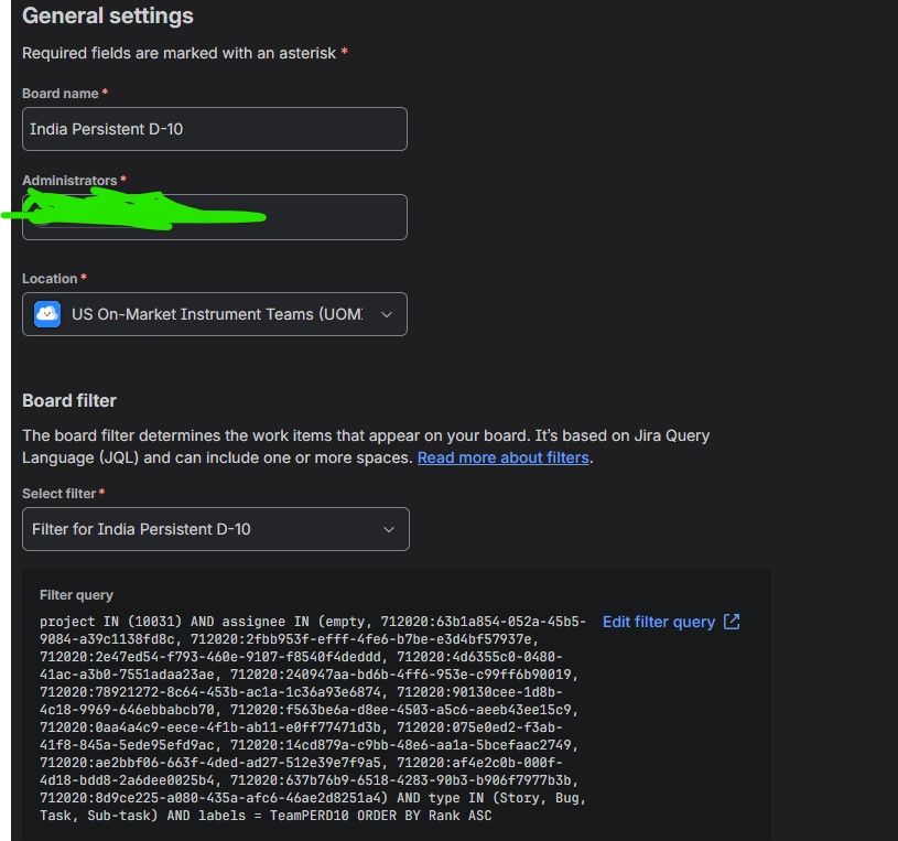

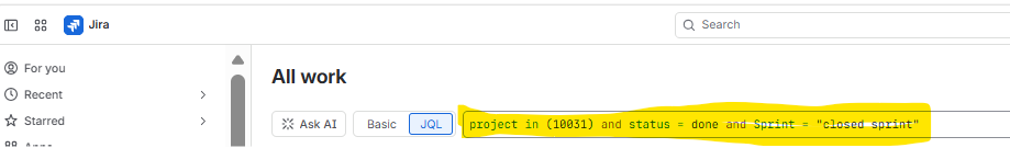

Please use the below JQL query to search for all available stories that are in Done status and still associated with a closed sprint.
You can run this query using the Issue Navigator Search Work Items:
project in (10031) and status = done and Sprint = "closed sprint"
Note: For Sprint = "closed sprint", please replace it with the relevant closed sprint ID or sprint name from your project.
