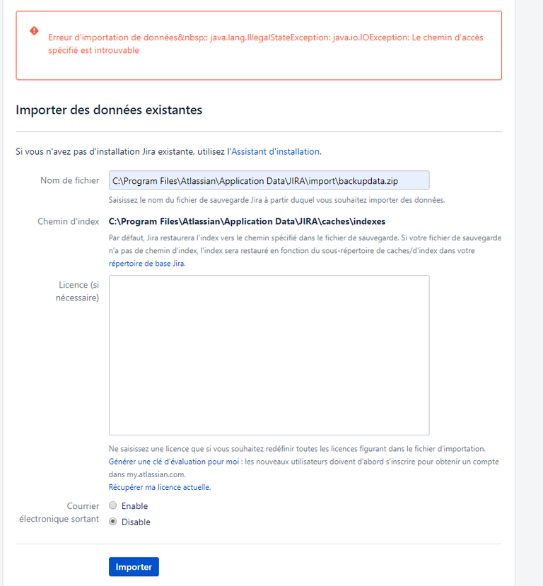

After configuring my local jira instance with Mysql , i would like to import data witch i did the backup from the H2 database , now when i try to importing data from the folder import:
the path : C:\Program Files\Atlassian\Application Data\JIRA\import\backupdata.zip
First it start to import then , an error appear :
this is my log:
java.lang.IllegalStateException: java.io.IOException: Le chemin dӡcc鳠spꤩfi顥st introuvable

Caused by: java.io.IOException: Le chemin dӡcc鳠spꤩfi顥st introuvable
at java.io.WinNTFileSystem.createFileExclusively(Native Method)
at java.io.File.createTempFile(File.java:2024)
at java.io.File.createTempFile(File.java:2070)
at net.java.ao.db.FileSystemUtils$1.get(FileSystemUtils.java:25)
... 25 more
Can any one help me !
Regards
Alexey Matveev
April 26, 2019
Hello @[deleted]
Just write backupdata.zip. Do not provide the absolute path.

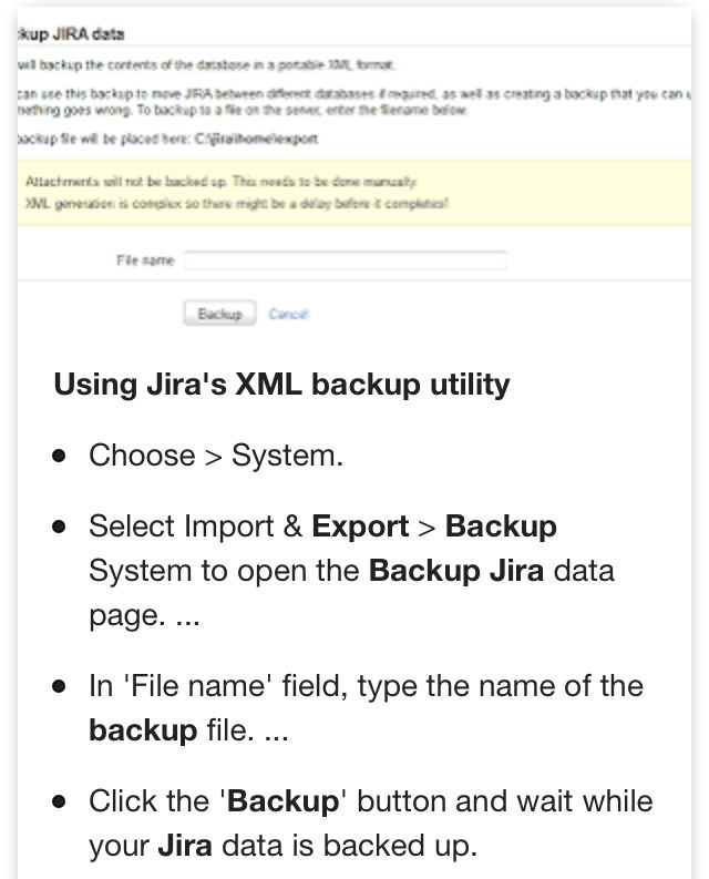

Deleted user
April 26, 2019
@Alexey Matveev  thank you very much , but here  i have other problem
that error : Erreur lors de l'analyse du fichier d'exportation. Votre fichier d'exportation n'est pas valide. Cela peut être dû à un bogue CDATA dans des versions antérieures de JIRA (http://jira.atlassian.com/browse/JRA-4980). L'exception est org.xml.sax.SAXParseException; lineNumber: 1; columnNumber: 1; Content is not allowed in prolog.
regards
Alexey Matveev
April 26, 2019
It means that the backup has the wrong format. How did you take the backup?
Deleted user
April 26, 2019
I go to the export backup it’s an xml backup
it give a file format .zip this folder include two file
1. Active...
2entities
Alexey Matveev
April 26, 2019
What are the versions of Jira from which you take a backup and to which you import the backup?
Deleted user
April 26, 2019
I take the buck up from Jira 8.1 and I import the buck up to Jira 7.13 , i have question it must be the same version ?
Alexey Matveev
April 26, 2019
I believe that is the reason. You can not import Jira 8 backup to Jira 7
