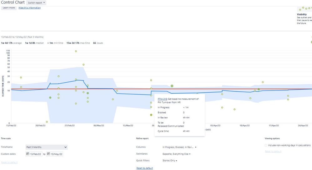

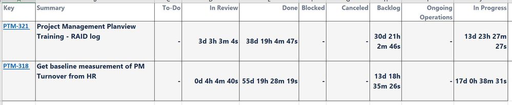

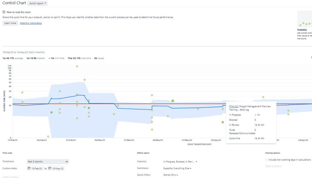

The data from the Control Chart Report in Jira Software is so different from Time in Status add-on in Jira Software (which seems more correct) for some issues (but not all). Is there a reason that time lengths on the control chart would reflect different then the time stamp issues sat in a certain status? We have have a lot of teams questioning if the Control Chart data is accurate if it does not match the Time in Status data. Any helpful tips or explanation for why this is would be occurring will be greatly appreciated in understanding the Control Chart better.

Thanks @Emre Toptancı _OBSS_  for your quick response. I have attached a couple of example showing Control Chart Report data VS Time in Status data, I hope this helps.
Time in Status Data Example.JPGJira Issue PTM_321Example.JPGJira Issue PTM_318 Example.JPG

I noticed that you didn't select "Include non-working days" for your Control Chart report. Kanban boards have Working Days setting in Board Settings. I guess your report excludes non-working days. On the other hand, your Time in Status app report might include them.
I remember reading a lot of complaints from other users in the past about the Non-Working Days checkbox of the Control Chart not working as expected. We don't have an easy way to see how this checkbox affects the calculations but, you might try getting a report while it is checked.
