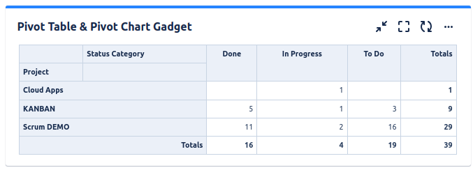

Hi @Jan G_,
Very helpful for your case would be the Pivot Table & Pivot Chart gadget offered by our Great Gadgets app. By using this gadget you can create multi-dimensional tables based on the issues from a filter/JQL.
So you can use it as a two-dimensional table. And it supports the Status Category field.
You can configure it to display count of issues:

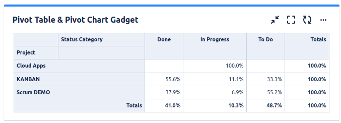

... or percentages:
You can start by installing the 1-moth free trial. If you have any questions, feel free to contact us at support@stonikbyte.com.
