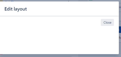

Hi All,
We faced an unusual problem with our Jira Server. After migration, the instance all work fine besides the editing layout of Dashboards. Is anyone faced with this kind of problem?

Check the Base URL of the Instance in System Settings and just to confirm are you using any proxy when accessing Jira?
We would need more context than what you have provided for troubleshooting the Dashboard error. Are you seeing a blank page when the edit option is selected?

Thank you for your answer. The base URL changed after migration and changed to the correct URL, but the problem was elsewhere. One of our plugins was the reason, after removing it, the issue was resolved. Now it's working fine.
