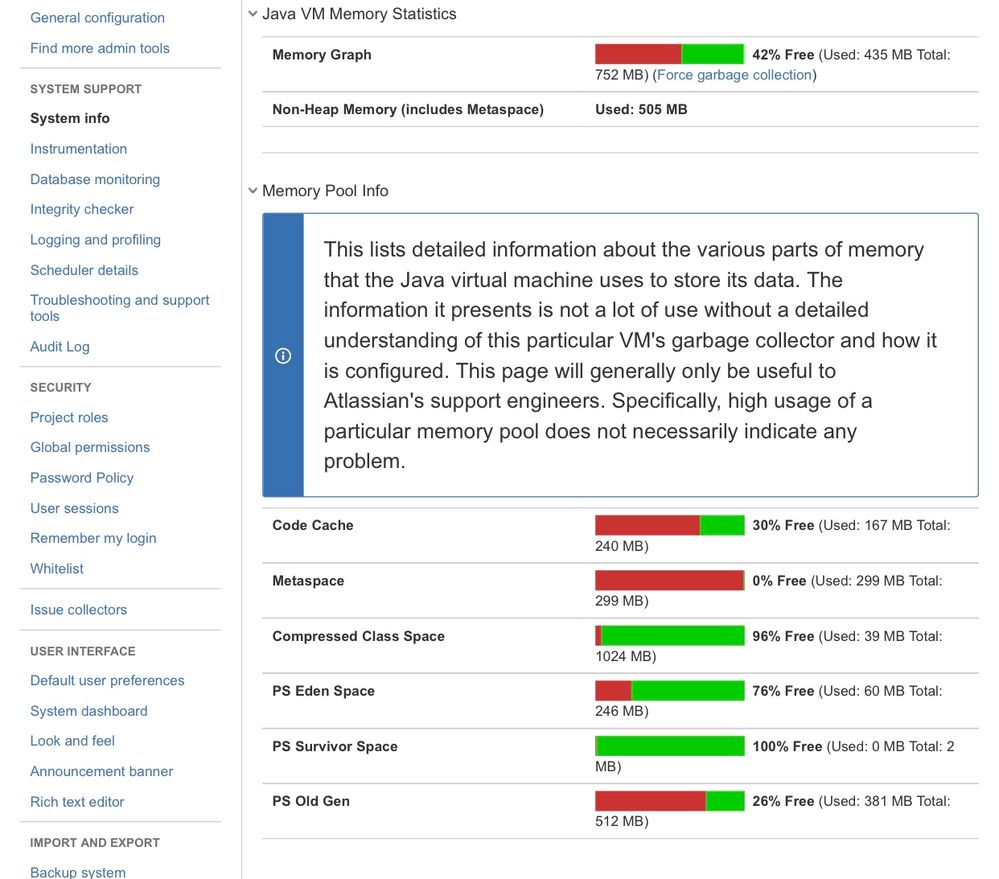

Have you gone into the system to review things such as Java virtual memory?
Yes, everything is at least 26% Free, except for the metaspace which shows 0%.

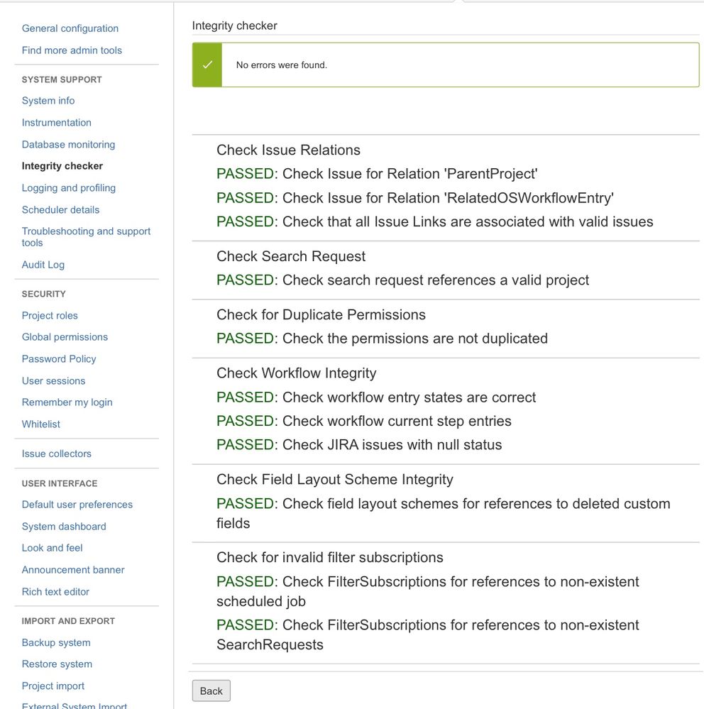

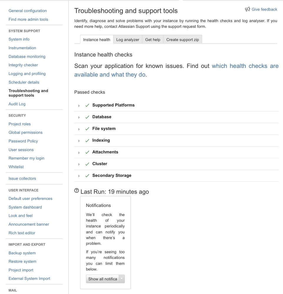

All integrity and health checks pass in JIRA.

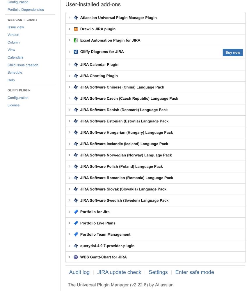

I first noticed the issue around the time I installed the Git Integration for Jira plug-in, but even after uninstalling that, the same issue still comes up.

Metaspace is as designed to be functioning at 100%
Can we take a look at the default dashboard settings?  Lets see if there's any gadgets that weren't removed from the git integration add-in.
