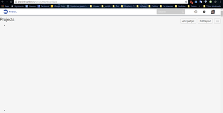

Hello. I upgraded to 7.9.0 self hosted Jira with Starter License, only one 3d party plugin for Git.
And now all dashboards look ugly.
Also a lot of errors in Chrome console about not found CSS.
Chrome console log
Does anyone know what can be the reason and how to fix it?
Thanks.

I thanks for the HAR file, I found a number of 404 errors in it. This is just an indication that the files being requested by the browser are not able to be located.   These all appear to be css and js files.  Which would explain why the pages don't appear correctly.
I also found another interesting URL in your HAR file:
http://jira.riedl-gmbh.eu/mod_pagespeed_beacon?url=http%253A%252F%252Fjira.riedl-gmbh.eu%252Fsecure%252Fadmin%252FEditDefaultDashboard%21default.jspa
This 'mod_pagespeed_beacon' specific URL is not native within Jira by itself, so it must be a product of your Apache environment.  I suspect that this either the mod_pagespeed module is causing the problems, or there is some other configuration on the proxy side that might need to be adjusted to correct this.
There is another KB called Changes in JIRA not Visible Until Manual Refresh in Browser that deals with other problems that can be seen in Jira when using the pagespeed module in an Apache proxy.
While that KB might not be the exact same problem you are seeing here, I would like to try the same resolution there because I think the source of the problem is this module:
Resolution
Verify if any pagespeed modules are running in the Apache HTTP server by running the following command to list the loaded modules (Linux Only):
# apachectl -t -D DUMP_MODULES
If any pagespeed module is loaded please work with your System Administrator to disable them
Also, your connector should probably also have the proxyName, proxyPort, and scheme parameters defined in it, since it's clear that there is either a proxy or some other redirect happening here.   In Jira's server.xml I would recommend altering your connector to look like this:
<Connector port="8800" maxThreads="150" minSpareThreads="25" connectionTimeout="20000" enableLookups="false"
 maxHttpHeaderSize="8192" protocol="HTTP/1.1" useBodyEncodingForURI="true" redirectPort="8443"
 acceptCount="100" disableUploadTimeout="true" bindOnInit="false" proxyName="jira.riedl-gmbh.eu" proxyPort="80" scheme="http"/>
This way the Jira site is aware that traffic to it is actually being first directed to another site/address.  Without this, you are likely to encounter other problems with Jira rendering pages due to built in cross site scripting protections.  Please note that after you make changes in this server.xml and save them, you have to restart Jira before these settings will take effect.
Riedl-Taras April 18, 2018
It is an old VM with obsolete software from Bitnami, and they really had this Apache module. Jira works fine after I disabled it.
Thank you very much.
