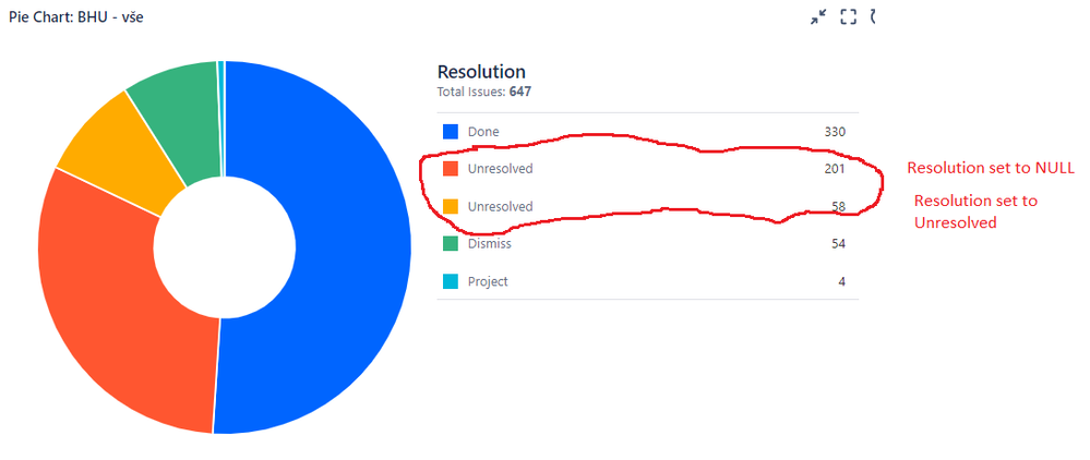

Hello,
The interpretation of the Resolution attribute in the graph for values EMPTY and Unresolved is confusing.
Both JQL:
  • project = BHU AND issuetype = "Change Request" AND resolution is EMPTY ORDER BY created DESC
  • project = BHU AND issuetype = "Change Request" AND resolution = Unresolved ORDER BY created DESC
has the same result 201 rows.
JIRA replace the EMPTY value with Unresolved in JQL, but it does not do the same in graph interpretation and data export.
Hot to get 58 rows with JQL.
Mark Segall
October 21, 2022
Hi @petr_rihak_uniqa_cz and welcome to the community!  By default a "null" resolution is Unresolved.  So, in this case, you've created a new custom resolution of "Unresolved". Therefore, you're seeing the duplicate branding.  Recommend that you rename your custom "Unresolved" resolution to something else.

@Mark Segall I have the same kind of problem (DC Jira). We have not created any new resolutions. If I clic Unresolved like in picture above it opens filter and filter ends like resolution is empty.  and in all issues filter shows resolution is Unresolved. And If I click the other unresolved row filter ends like resolution = unresolved. Filters listed same issues in both filters but numbers in pie chart are different.

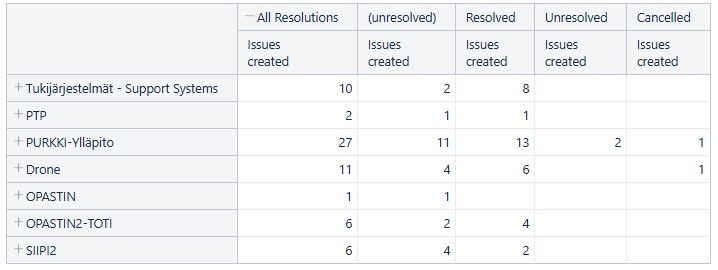

@Mark Segall Answering by my self. I found out that there actually is two different values for resolution. (unresolved) and Unresolved.  Eazybi helped to find that difference. Both values look all the same in Jira. I have no idea how it is possible.

We found out that the problem rise at  situation when resolution is changed (workflow post function). When resolution (for example cancelled) changes resolution date appears in date section:
Resolved: Yesterday 3:49 PM.  If that issue is reopened and status is changed to in progress, resolution date cleared and resolution value set to unresolved (Workflow post function). Resolution date remains and Resolution is Unresolved but it is written "Unresolved" not (unresolved). In Jira result is like the picture above. Eazybi gives results like below

In Jira resolution is empty in the beginning. When value is empty user sees it as unresolved (unresolved). If resolution value is changed for example in post function resolved date appears. And if you want to change the value back to unresolved Resolution value and resolution date should be cleared.
Our mistake was that when we reopen the issue we put resolution value to unresolved in post function.  Result was that we had two different unresolved values. original: (unresolved) and the other defined in post function: Unresolved. (unresolved) is not equal with Unresolved in resolution field.
We have one Unresolved resolution in resolution value list. Empty value is not visible in list and that empty is the native unresolved value in Jira.
