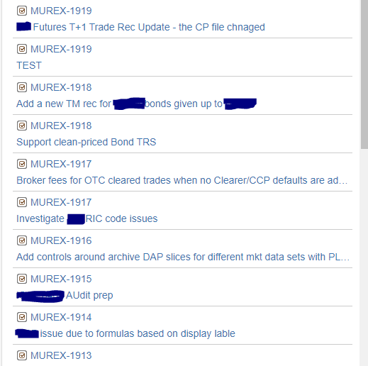

Thanks for the response, Alexis.  I have indeed run a full re-index, but when I look at 'All Issues' for this particular project, I see duplicated issue numbers for the 3 problem numbers - 1917,1918,1919 (we cloned one of them to see if that changed what the user saw).   I say duplicated numbers, as you can see below that the suibjects are different

You should definitely not have duplicate key numbers, that's clearly not right.
What's the URL when you open MUREX-1919 (the TEST one and the Futures one) ?

Appreciate your time here Alexis, thank you.  The URL is the same:
http://jira.somedomain.com/browse/MUREX-1919
Both 1919 links bring up the 'TEST' data, indeed when I click on the Futures link (i.e. the one which the dB 'lost' post-restore), it just moves down to the 'TEST' one.  It's as though the link to 1919 remained post-restore, but the destination has now been replaced by new data.
