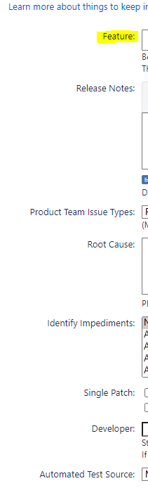

Is it possible to filter what are the fields that we need to pop up to fill when moving an issue from issue type A to issue type B? in the same project but with two different field configurations, I found that not all the fields are visible that in the associated screens or the field configurations and fields are not mandatory.
The requirement is to hide the Feature field when from issue type A to issue type B? in the same project, but has to be visible and enabled in the issue

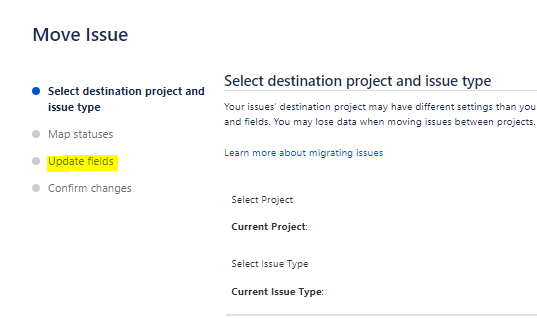

Hi @Mark Segall
I need to manage the fields  that are visible in the below step,  as in the above image highlighted field is visible to update, the requirement is to hide it in the below step but to enable and visible in the issue view and edit screens  Capture.PNG
Mark Segall
August 19, 2022
Unfortunately, this is not possible.  The entire move process is hard coded.  It's always going to prompt for project/issue type and ONLY the project/issue type.

oh, I see, but why only some fields are visible not all the fields,
like the "Root cause" field, there is another field named "Root cause theme"  it's not visible in the move process.
