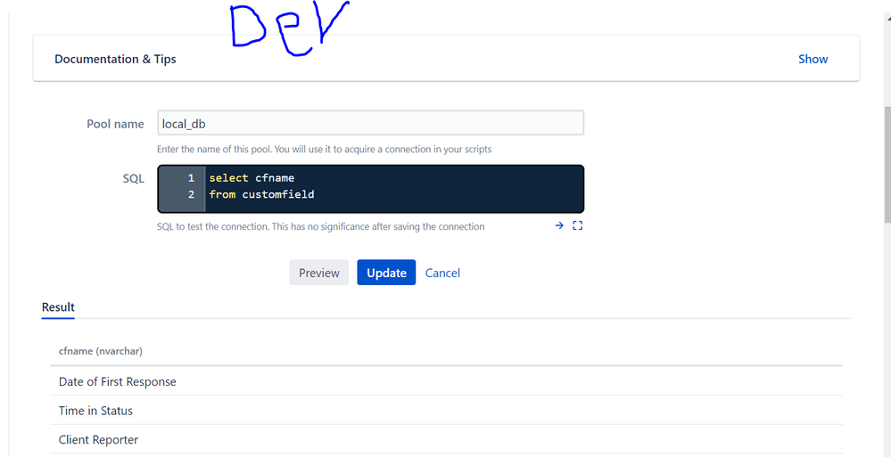

Hi Guys,

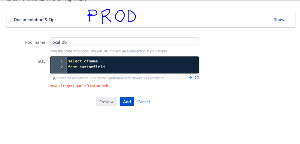

Need your help, i am trying to get list of Custom fields using SQL query using Script runner resources . in Our JIRA Dev environement it's working fine while in PROD Environment it's giving an error invalid object name 'customfield'. Kindly suggest..why prod is not reading tables or table in missing from prod database.

You'd be far better off using the API to get a list of fields, it's far easier to work with the fields directly in a script than have to look them up every time you want to get one from a name.
But to answer the question - you are connecting to the wrong database in prod, or it's of a type that is case-sensitive and the column is called CUSTOMFIELD or Customfield or something where the case matters.

Vikrant Yadav
May 29, 2021
Hello @Nic Brough -Adaptavist-  I have tried CUSTOMFIELD, Customfield and customfield in every getting same error "invalid object name".
I am using ScriptRunner Resources >> Local Database Connection
Thanks
May 29, 2021
I would guess that your "local_db" database connection pool is set up to point to the wrong database.  It's either going to one that isn't responding or its empty.   Either way, it's not connecting to your Jira database.
