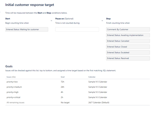

Are you able to attach a snip of your SLA rule?
Rob Barry
March 7, 2018
Meg Holbrook
March 7, 2018
Reporter is customer in this scenario, so you're saying that your agent is the reporter, correct?
Select a non-agent name as the reporter.
Meg Holbrook
March 7, 2018
To clarify my response; users in the reporter and participant section (while working within help desk) are classified as customers for the purposes of SLA triggers.
If your agent is present in the Reporter or Participant section, they will trigger 'customer' actions.
