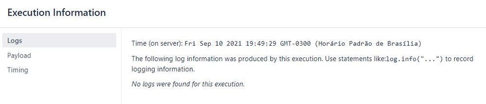

It seems that the validation script isn't running (but is running), and I didn't receive the log info return.
In attachments are some prints from my WF.
Can you kelp me?

Why is null a string within your code block? It seems to me the script ran and found that the condition set didn't match, so it skipped the block and exited.

The green "script has run ok" flag is only telling us that the script ran and "worked" - for a validator, that means it returned something to Jira that was a "yes or no on the validation question".  It will only go red/fail when the script fails or crashes and returns "it's all gone horribly wrong"
