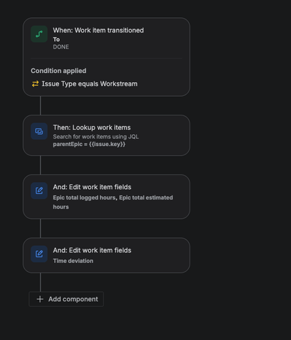

I just tested the automation and the following error occurred:
I’m attaching a screenshot of the automation rule:
Would I be missing anything else?

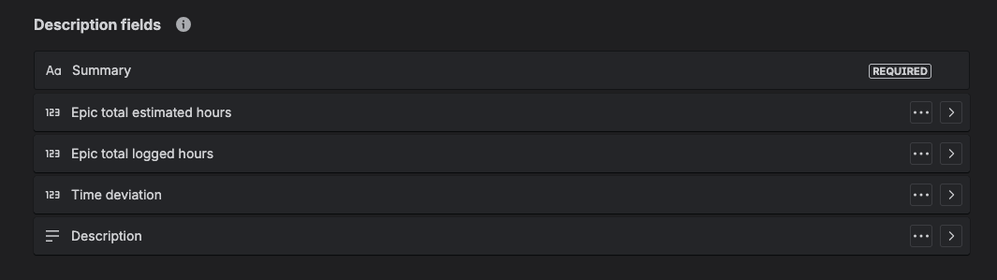

I’m adding the type of fields configured:

The error happens because “Time deviation” is a Number field, but the value your rule is trying to write is not being interpreted as a number at runtime (often because one of the source smart values is empty/null, or the calculation is evaluated as text).
To fix it, make sure your “Time deviation” edit uses a math block and converts inputs to numbers with a safe default:
In the “Edit work item fields → Time deviation” action, set:
({{issue.customfield_<logged>.asNumber|0}}) - ({{issue.customfield_<estimated>.asNumber|0}})
Replace <logged> with the custom field id for Epic total logged hours
Replace <estimated> with the custom field id for Epic total estimated hours
.asNumber forces numeric conversion
|0 prevents failures when one of the fields is empty

Álvaro Boza
February 19, 2026
I think the problem is with the summation of the task hours. I tried this variant that works with just 'issue' in another automation, but it doesn’t pick up any data—it returns 0: {{lookupIssues.timetracking.timeSpentSeconds.sum.asNumber|0}}
Álvaro Boza
February 19, 2026
Hello,
It finally worked with this:
{{#=}}{{lookupIssues.timetracking.timeSpentSeconds.sum}} / 3600{{/}}
