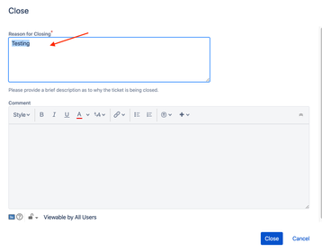

Background: I wanted to set up a screen to pop up when an issue was transitioned to Resolved. First, I created a Custom Field "Reason for Closing" (Text-field, multi-line). I have assigned that onto a newly created screen which then was set up for a transition between Working Status >> Resolved. It is popping up nicely as I wanted.
1. When a user is prompted for this, the user would then write the reasons as to why they are closing the issue. Let's say they wrote "The project is complete" and close the ticket. Where can I, as a project admin, find these answers the users have provided? How will the project admin keep track of the answers that were provided?
2. Also, I wanted this field to be mandatory. So, I have set it as Required field within Field Configuration. This was successful and made the users not be able to close the tickets without answering. However, the users were not able to create issues because the issue creation window kept on saying "Reasons for Closing" field is required despite the fact that field is not on the issue creation window. How can I isolate this required field to be ONLY required on that transition screen without affecting issue creation window?
Thank you so much in advance. Let me know if I can clarify myself even more.

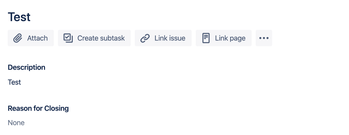

I would have Field only show up as required field on a transition screen from In Progress >> Resolved (This was successful). Then, once the field value was not empty, admin would be able to see the value and be able to have a JQL filter run. However, I found out that the text field cannot pop up on View Issue screen ONLY when then field value is not empty. At least not without tweaking via Behaviour. At the moment, I have the field showing up even on Open Issues which is not what I would want. After searching around the Internet, I have found it still impossible (after years of request) to show text field only when the there is a value.
Am I correct?
