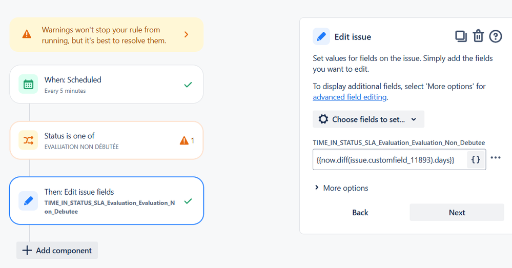

Thanks for the answer. What you propose in your Question, will not give the result that I need.
I want like a timer when a issue stays at at Status A. So it's not a static data it change all the time as time goes by (Date now - Date Stamp when transition to status B).
So for that, I guess that I need a Schedule in the automation (like each day). But it does not work, and it gives me a warning.
Each 5 minutes (for testing)
when status is on: Evaluation non débutée
Edit that field:

EDIT: customfield 11893 = Time stamp when issue transition to statuts EVALUATION NON DÉBUTÉE

@Loic
The reason rule is not working is, Scheduler needs either a JQL or lookup query post the scheduler is triggered.
in the current set-up if condition has nothing to act on as no issues have been fetched.
Therefore, first a JQL query needs to be finalized based on which scheduler can get the issues that it needs to act on.
Timer like functionality is not available out of the box in JIRA.
