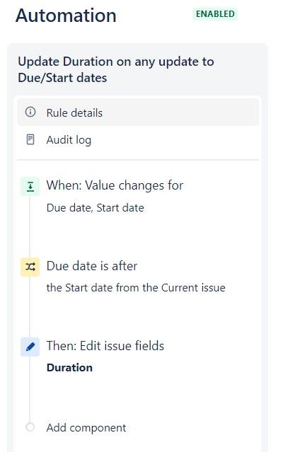

Automation put in place is

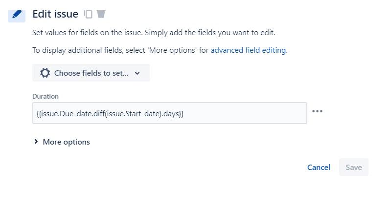

I configured a smart value for Edit issue fields in the following manner to achieve what I wanted

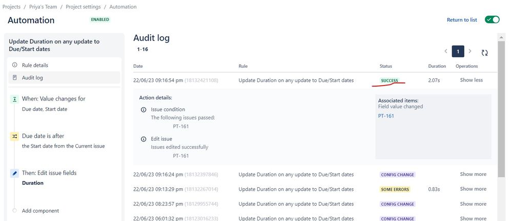

When the automation is executed, the automation log shows success. Here's the screenshot

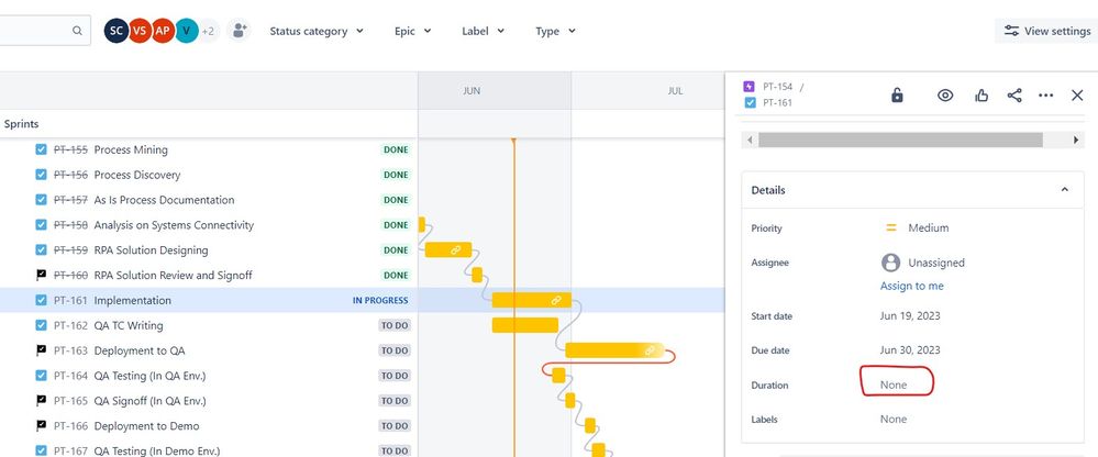

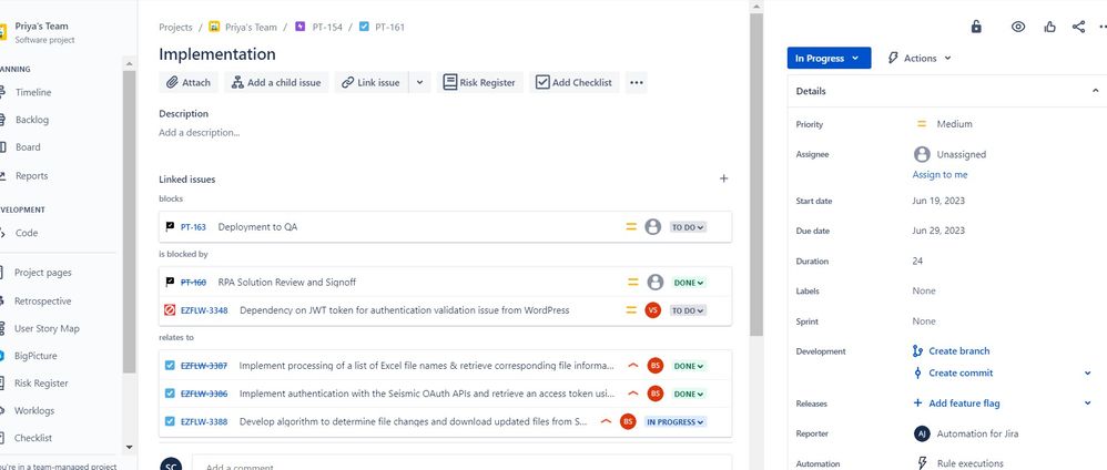

However I am not getting the desired result i.e number of days is not getting populated in the 'Number' field 'Duration'

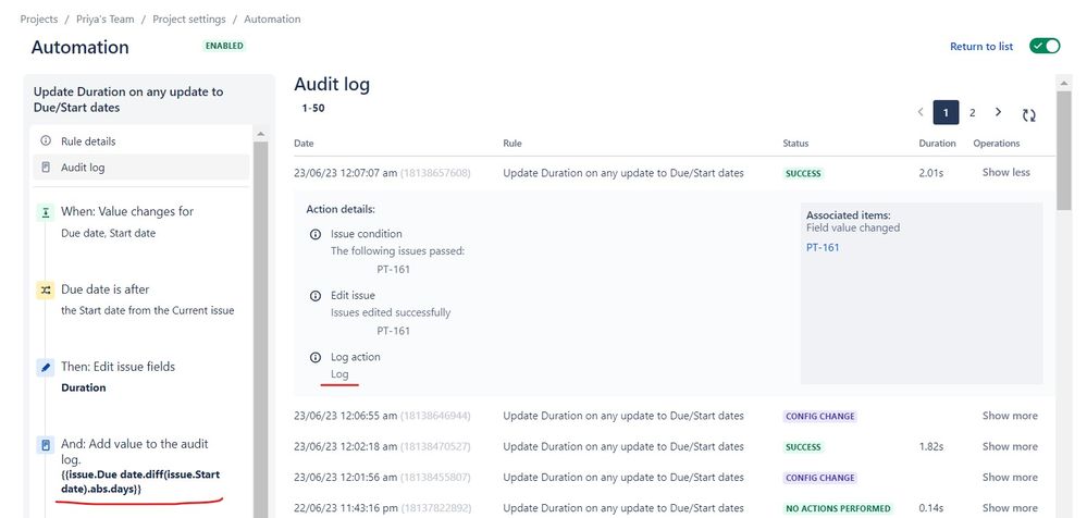

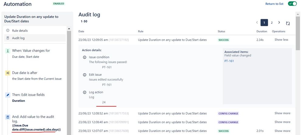

Just to check if it is working with other date fields I tried with 'created' date and it worked actually

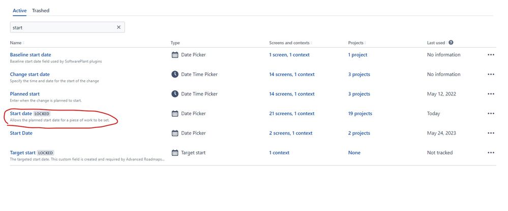

Note:- I haven't custom created 'Start date'. Its an built in date field.
Start date not custom.jpgDo you see any other root cause?

Note that the Start date field you show in the last screen you posted is not necessarily the same as the Start date field used in a Team Managed. That screen lists custom fields that have been set up for Company Managed. projects. Such fields that have been defined with a Global context may be used in a Team Managed project, or the Team Managed project may have an identically named by local custom field.
The custom fields available in a Team Managed project can be localized to belong to only that project, and as such may have the same name but be referencing a different storage space in the back end. You can confirm this with by checking the ID of the custom field.

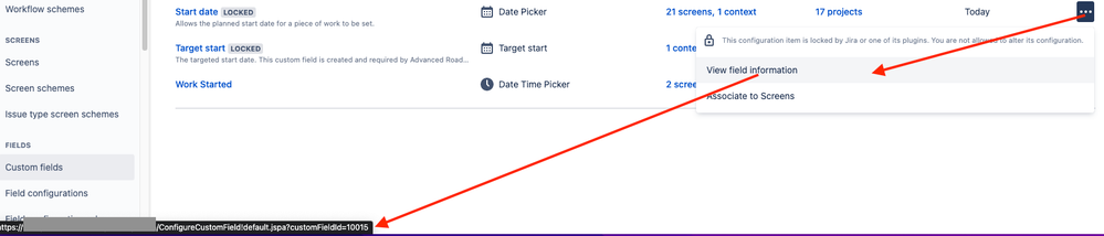

From the screen you showed listing Custom Fields you can find the field ID by hovering over one of the Action options and looking at the URL that shows at the bottom of the browser.
