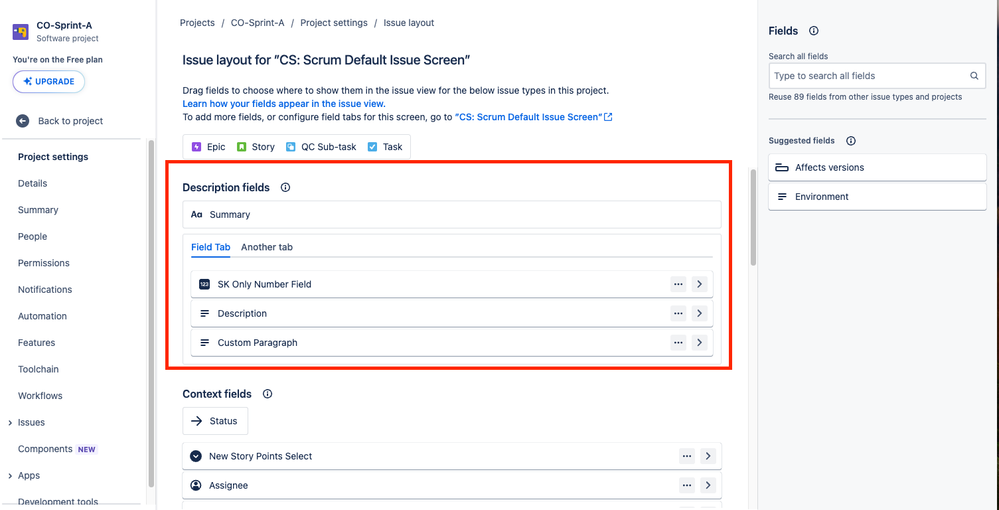

Hello @Jenna L'Esperance
@Derek Fields _RightStar_ 's answer is not correct.
You can move the fields through the Issue Layout option to reposition then in the same area where Description is displayed.
https://support.atlassian.com/jira-software-cloud/docs/configure-field-layout-in-the-issue-view/
Here is an example where I have moved the SK Only Number field from the Context Fields section (fields shown on the right in Issue View) to the Description Fields section (fields shown on the left in Issue View)

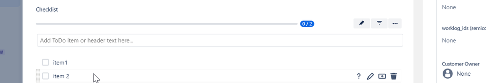

Hi @Jenna L'Esperance
You can use Issue Checklist for Jira free to create Checklists and view them on the main Issue panel.
as shown:
Checklists with Issue checklists are easier to manage and can help you create simple automation around them to automate your processes.

Jenna L'Esperance
February 12, 2024
Thank you, @Trudy P Claspill !! I was able to follow your instructions and now see the custom fields in the "main" area of the ticket exactly where I need them to be.
