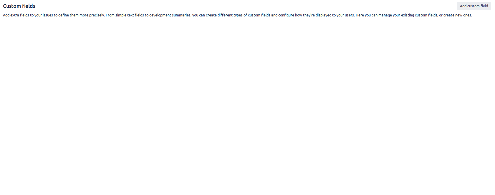

I'm urgently looking for a solution to see my custom field list in the admin view:
Normally there should be about 34 custom fields listed. But since a few days (can't say how long) the list is empty and there is no search input bar either.

Thanks for your quick answer. I tried different browser and its the same as in the screenshot - empty. I had a look with the browser developer tools but there is nothing special only the empty container for the div which normally include the custom fields html.
