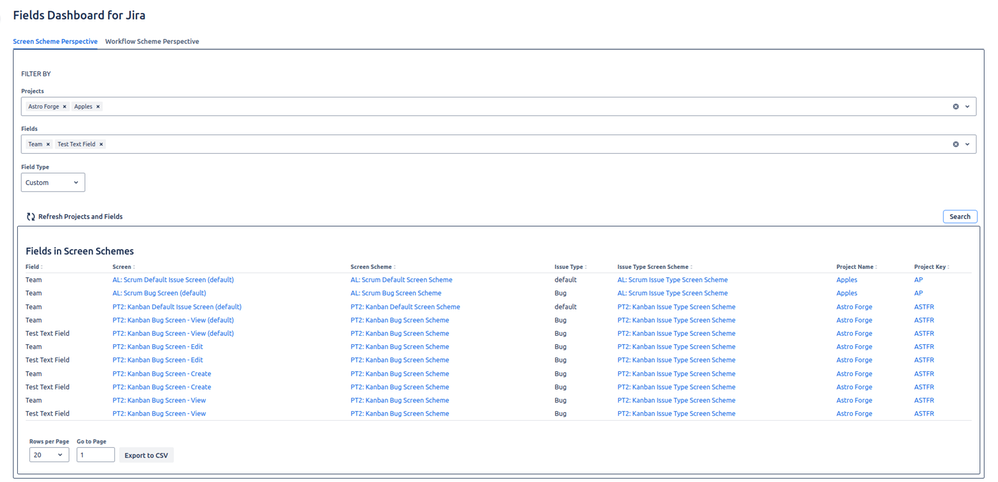

Petru Simion _Simitech Ltd__
Atlassian Partner
January 6, 2026
Hi @Sara Innes ,
Field cleanup in long-lived / migrated Jira sites is always tricky — especially when you also have retention requirements. And you’re absolutely right that simply searching for “field X is not empty” won’t always tell the full story, because:
✔ Archived projects are excluded
✔ A field may still be configured somewhere even if it has no values
✔ Fields may be referenced in screens, workflows, post-functions, or field configs
So before deleting a field, you really need to confirm two independent things:
1️⃣ Is the field ever populated with data?
(historical or current — including archived projects)
2️⃣ Is the field still in use anywhere in configuration?
Examples:
  • included in a screen or screen scheme
  • referenced in a workflow condition/validator/post-function
  • used in a field configuration
  • used in transitions or automation
Even if a field is empty today, deleting it when it’s still wired into a workflow/screen can break real-life processes.
A safer way to approach cleanup
Instead of unarchiving projects and bulk-rewriting ticket descriptions (which can create noise, audit overhead, and rate-limit pain), I’d recommend getting full visibility first.
Tools exist to map exactly where a field is being used across the site, including projects, screens, workflows, and schemes.
You can use, Fields Usage for Jira an app released by our company.
It lets you see for any field:
✔ whether it’s referenced in screens / schemes
✔ whether it appears in workflows
✔ which projects it’s actually enabled in
✔ whether it is safe to retire
That way you can:
🔍 Identify true legacy fields
🧹 Confidently detach them from configs
🗄 Preserve historical data without rewriting issues
🛡 Avoid workflow/screen breakage
📑 Stay compliant with retention policy
Once you verify a field is not populated and no longer used anywhere in config, then cleanup becomes much safer and predictable.
You can search for all fields or filter them out,  analyze your fields usage or export them to csv for further analyzis.
fields_dashboard_scheme_search_result_for_designated_projects_and_only_custom_fields.png
Regards,
Petru
