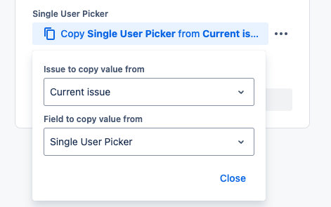

You don't need to use Advanced Options and JSON for that.
If you want to copy the value of one User Picker (single) field (like Assignee) to another User Picker (single) field you can do that with the Copy option in the Edit action.
That changes the text in the field as shown below. Click on that text and you get a pop-up to select the issue and the field from which you want to copy the value.
Change the Field to copy value from to Assignee.
