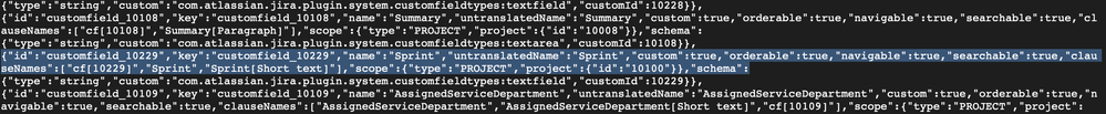

I'm using Jira Cloud and am running into a bug when trying to perform some automation. Someone in our organization created a custom field called Sprint that is a short text field when they were configuring their issue details. Because of this, automation is failing when I attempt to update all items in the sprint, because it doesn't know whether to use the built-in default Sprint field or the custom short text field that was inadvertently created.
I used the API to find the duplicated field as shown in the screenshot below:
I'm sending the following command in a terminal:
curl -X DELETE -u <user>:<api_token> -H "Accept: application/json" "https://<domain>/rest/api/3/field/customfield_10229"
and I receive the following response:
{"errorMessages":["Field not found."],"errors":{}}%
I also receive this same error message when I try to view the field in a browser at the following endpoint:
rest/api/3/field/customfield_10229/context
Can someone please tell me how we can get rid of that field entirely from the database? It's causing a ton of issues and appears to be a bug on Atlassian's side. Thanks.

I had a support ticket created and the Atlassian folks were able to track down the outlier. See the following information from them:
After reviewing the situation, I discovered that the custom field in question was created in a Team-managed Project.
Currently, these types of projects cannot be managed through the API, which is why you're encountering the "field does not exist" error when attempting to delete it.
We have an existing feature request to address this limitation:
"Ability to Create and Manage Team-Managed Custom Fields with API"
In the meantime, the only way to delete the custom field is through the UI.
I've identified that the field was created in the Data Engineering project.
To delete it, you can access the Issue Types page and use the "Search all fields" function to locate the field by typing "Sprint."
From there, you will be able to delete it:
