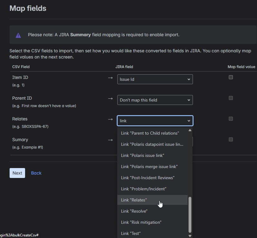

You could use something like this (I haven't actually used "Parent ID", so it can be removed):
During the import, you could then select link type (e.g., "Relates").

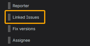

⚠️ When using bulk create via CSV, you need to have appropriate global permission and also all fields you'd like to import would need to be on create screen. In your case, you would need to have Linked Issues (yeah, they still didn't rename that to 'items'...) field on create screen to have a successful import. 👈

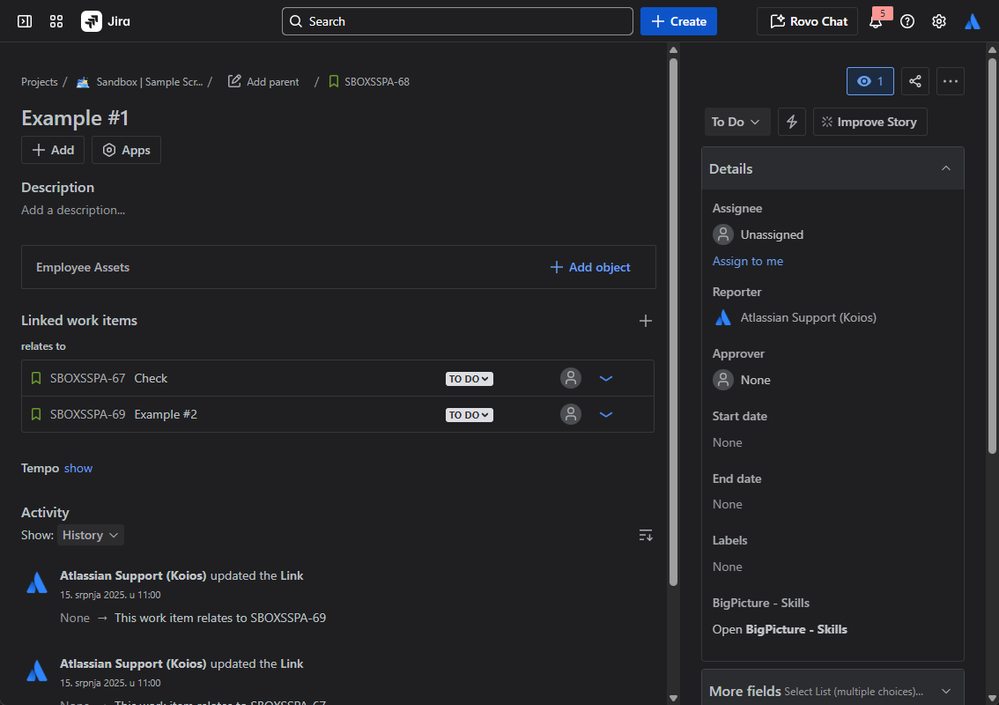

Anyway, this is what the result based on that CSV screenshot at the beginning looks like.
So, you could link an existing item, or an item that is also created via CSV import (a non-existent one). It should work in both cases.

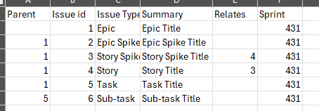

Hi @Tomislav Tobijas great, I think I've got it.
  1. Does the below format look correct as a template?
  2. Do I need to add the issue ID into both of them for them to relate back to each other or just into one of them?
Thank you for your help!

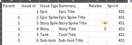

Tomislav Tobijas
July 18, 2025
Hi @rfrazier1 ,
  1. Yeah, this looks good.
  2. No need to add on both, you can only add ID to one of them. As import works in a way that it looks row-by-row, it will first import Story Spike with ID = 3 and it might try to set relation with item ID = 4 (which is not yet imported) and this might fail or drop an warning
    So, the recommended course of action would be to remove/delete the value from E4 cell and leave just the one in E5 > Story with ID = 4 relates to item with ID = 3 👈2025-07-18_14-57-24.png

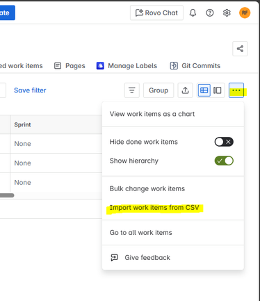

I am accessing it through the Project page - the three dots.  I believe I have minimal access in Jira.  I'm trying to link a story spike and story as relating to each other upon creation using the bulk csv function.
