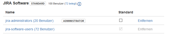

I think the access is configured correctly(Image).

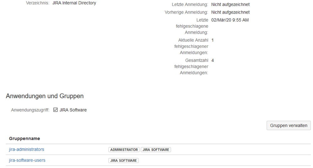

I have also attached the user configuration of the internal user
