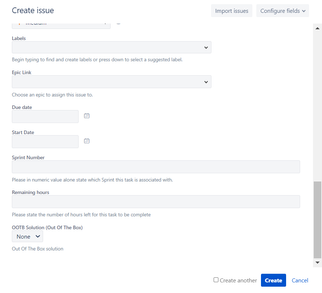

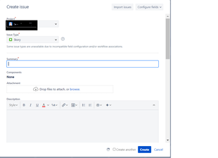

Hello,
I am currently involved in a project were we are using Jira as our Sprint board.  Our Sprint Board is made up of Epics, Stories, sub tasks and Bug.  So far, besides Bugs, all three issue types have the same field values.
The image above shows the fields I see when I create an issue type. What I would like to do is I would like to be able to create a Issue Type called "Risk" with a completely different set of fields needed to be filled in (for example, their would not be a Summary field for the Risk Issue Type). I am able to create custom fields as can be seen below but because they share the same Field Configuration Scheme any custom field that are created are shared among all Issue Type (besides Bug). I have tried to follow this documentation to associate a different field configuration scheme to an issue type but the documentation is outdated.

Yakub Mohamoud May 7, 2021
Hello John,
I apologize it seems I did not follow the instructions properly. The solution worked out well. What I failed to do was connect the screen scheme to the Issue type which of course would not work. Thanks you very much.
