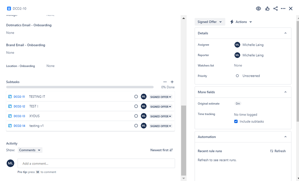

When the rule creates the subtask (even though i build the subtasks in automation & select fields to add)
The subtask creates BUT
No pulled over information from main issue (when we populate it)
No customer fields appear in the subtask

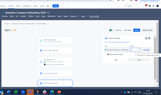

How i create the Rule with add subtasks and fields in subtask
When an issue is created > create subtask > add custom fields (to subtasks - these are all available in the global custom field list and are drop downs/check box types)
The subtasks all create fine but the custom fields are always missing from the subtask and the info from the main issue doesn't copy over to the subtask when we populate the main issue

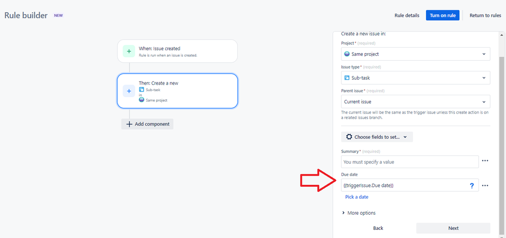

Hi Michelle - Welcome to the Atlassian Community!
For the fields you are copying down values for from the parent, include code like: {{triggerIssue.Custom Field}} where Custom Field is the exact name of the field you are copying the value from.
A couple of things. What are you doing in that third Sub-task create? It does not look like the other 2 and appears to be throwing an error.
Next, we will need to see the details of the fields when you are creating the sub-task (show the fields and the values you have in the fields for the Create sub-task action.

Correct if i just action/automate create a plain subtask its fine
But what i need to is in one of the subtasks i need to add specific fields in only that subtask
When and issue is created > Create subtask 1 > Create subtask 2 > Create Subtask 3
(1,2 & 3 must pull over info from the main issue when populated such as "name" or "location" - this info is populated manually when we create the issue)

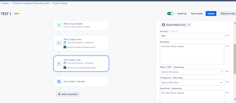

SUBTASK 4 must have custom fields
So after i have done plain subtaks 1,2,3
I go on to create subtask 4 - and ADD Fields
i choose the fields

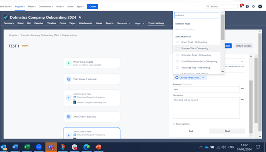

CHOOSING FIELDS
i create the rule to create another subtask but here i choose custom fields (these are all built and available in the global list and they are a mix of drop downs or check box)
i add the custom fields to subtask 4
And that's when it fails - it will create the subtask but without my custom fields

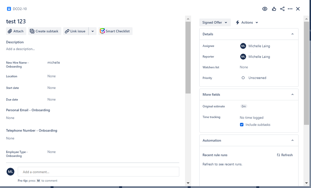

The other issue is
When i create an issue - then subtask - the info from the main issue should pull over to subtasks when populated as we build out the main issue - but this also doesn't happen
Okay, so this is from my original message:
Here is an example:

Any ideas on adding customer fields to be filled out later in subtasks that ARE NOT in the parent (main issue)
Nope! when i populate the main issue - it continues to stay blank in the sub task
I followed your guide exactly

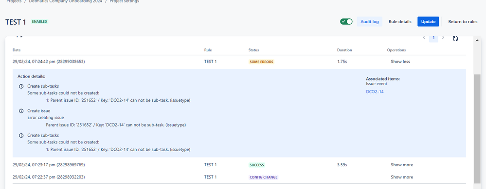

Can you post the new rule showing the details? And show the results in the audit log?
Fields to be added later can just existing in the Edit screen used by the Sub-task.

I figured it out!!
1. We had duplicate name fields so had to rename and pull from the correct one
2. subtask 1 - copy from current issue
3. subtask 2 onwards create separate "then action Subtask" copy from "trigger issue"

Also again please provide the details from the rule execution audit log for the last run that occurred after you made your change and didn't get the desired results.
